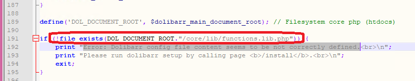

Hello :slight_smile:
it’s probably because your $dolibarr_main_db_host value is incorrect
you can find this error message in dolibarr’s source, in filefunc.inc.php
so that means your $dolibarr_main_document_root is incorrect…
good continuation
