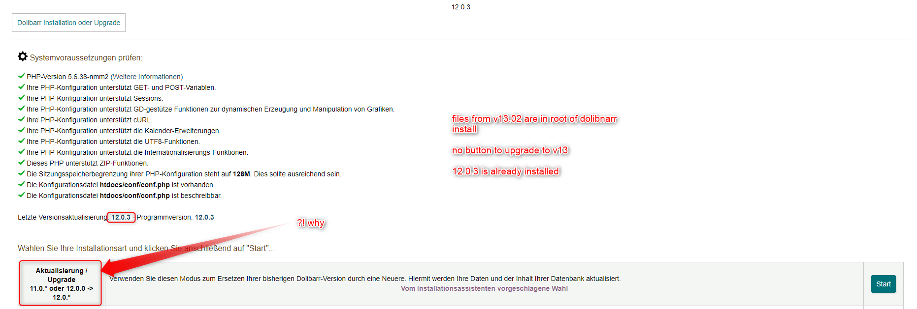

Problem with upgrade from 12 to 13
  • files unpacked from v13 zip into root
  • lock file removed
  • opened install path → no possibility to upgrade to 13.02
any one any idea why?

I also manged to get stuck in an update loop now. The system want’s to do the upgrade and doesn’t continue to let me in dolibarr even when i start the only available process (11 to 12).
Guess i have to restore the backup in the next step before i can continue.
Update: Deleting the update files in root was sufficient to brake the loop. But i have no clue how to trigger the update from 12 to 13.

Which is your current version please… Is it 12.0.4…? Otherwise, try to upgrade release by release.
thanks
yesbee
Current version is 12.0.3.
Thank you very much for your hint. I will try to update release by release.
kai
After checking the necessary steps, i decided to oped for a second instance with new version and import the backup.
