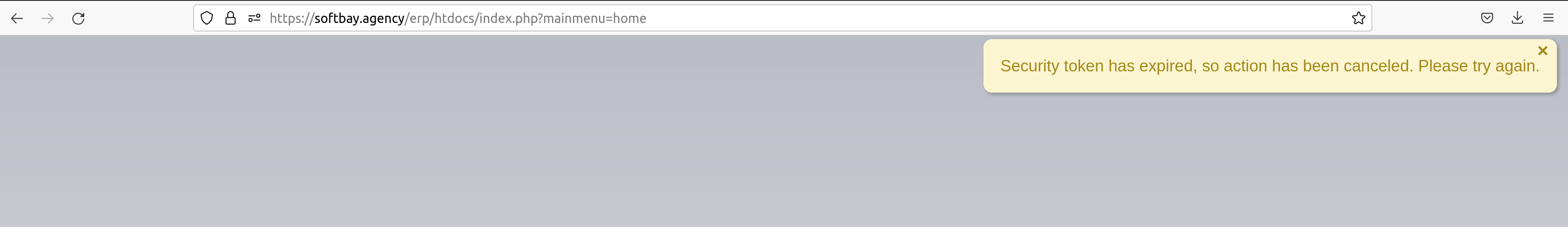

I just put Dolibarr 16 on a VPS hosted at OVH.
As you can see on the picture, I have the message of the expired token when I try to do a logging

Most probably you have an external module that creates the issue
I re-writted in english
@ksar Any solution about the issue?
I have given you the problem :
Is the first installation on this VPS
How can I detect the module ?
If it is a fresh install, then I assume that you do not have external module.
So the other possiblity is that you have issues with PHP_SESSION.
Check your server configuration regarding PHP SESSION
I reset everything and still the same issue
Is there a way to disable CRSF security?
After several investigations I was able to find out where the problem came from.
The directory /var/lib/php/sessions is write protected so dolibarr can’t save sessions on it
