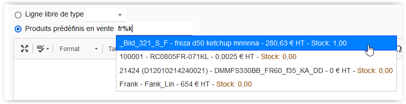

did you try with “%” as wildcard, in product combobox, this can be udes for selecting within ref or label products
for example : “quad%band%wifi” can be used for selecting all products with labels containing these 3 words…
In Dolibarr’s lists, you can also use the “^” at the beginning or at the end of your filter text, this is useful for filtering for every name, label or text …

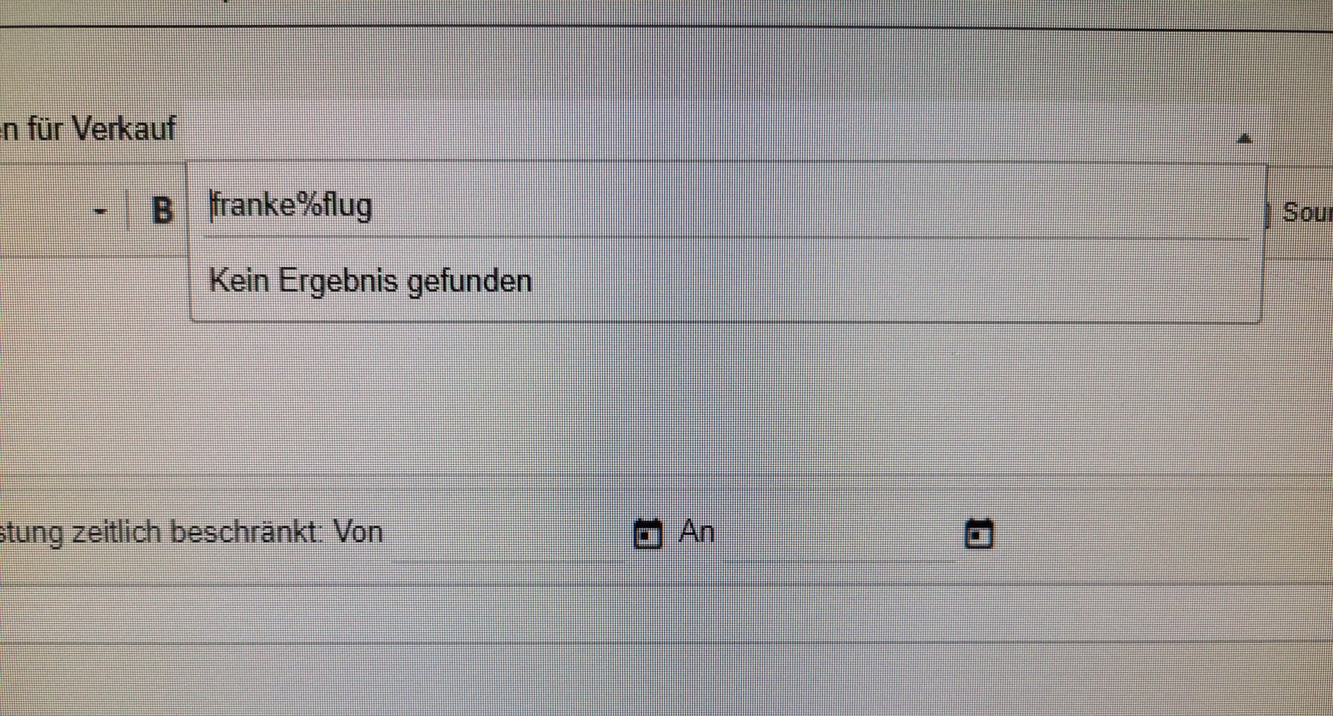

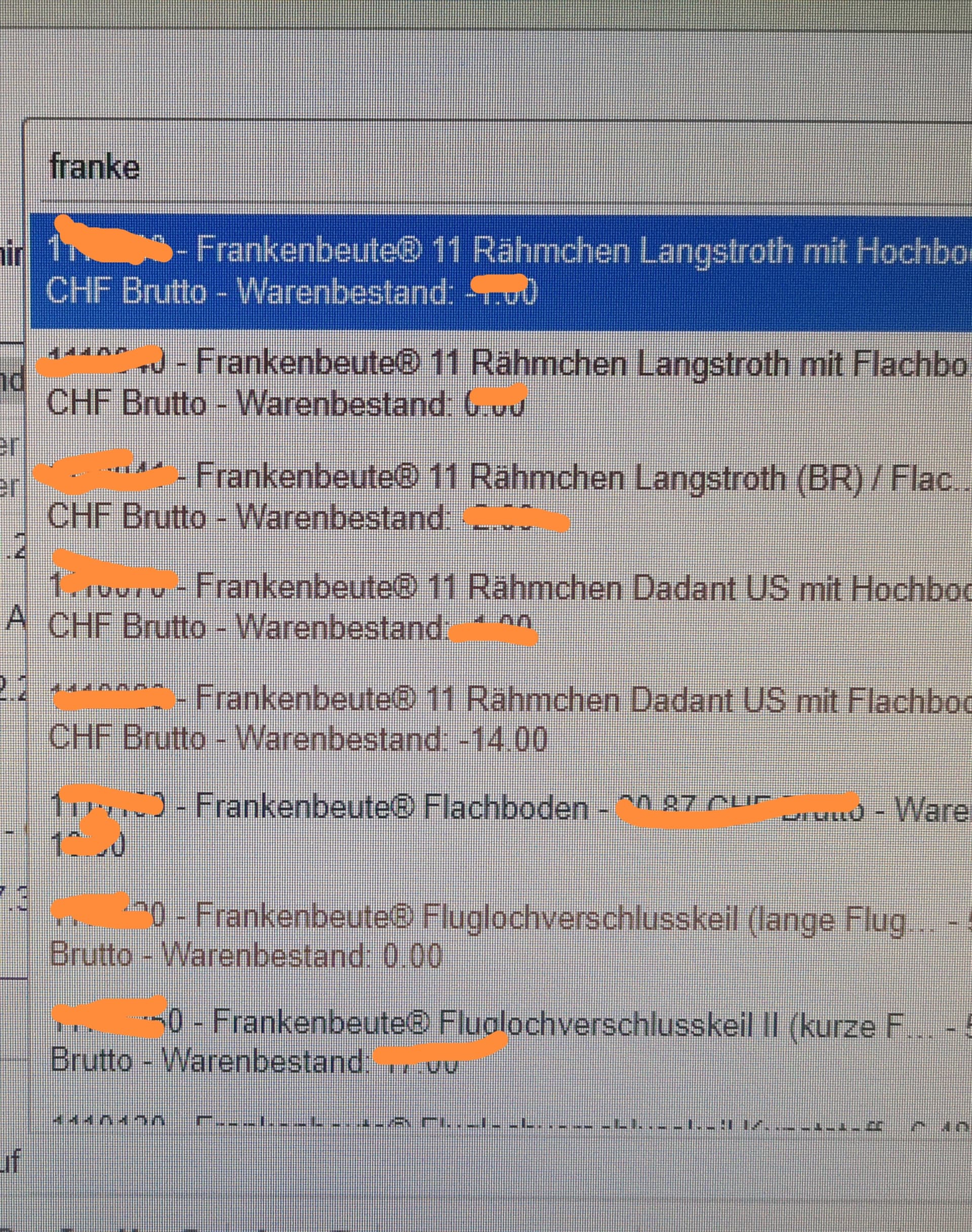

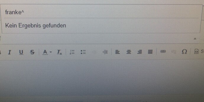

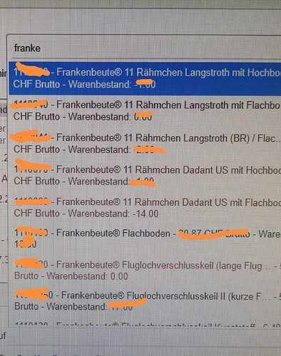

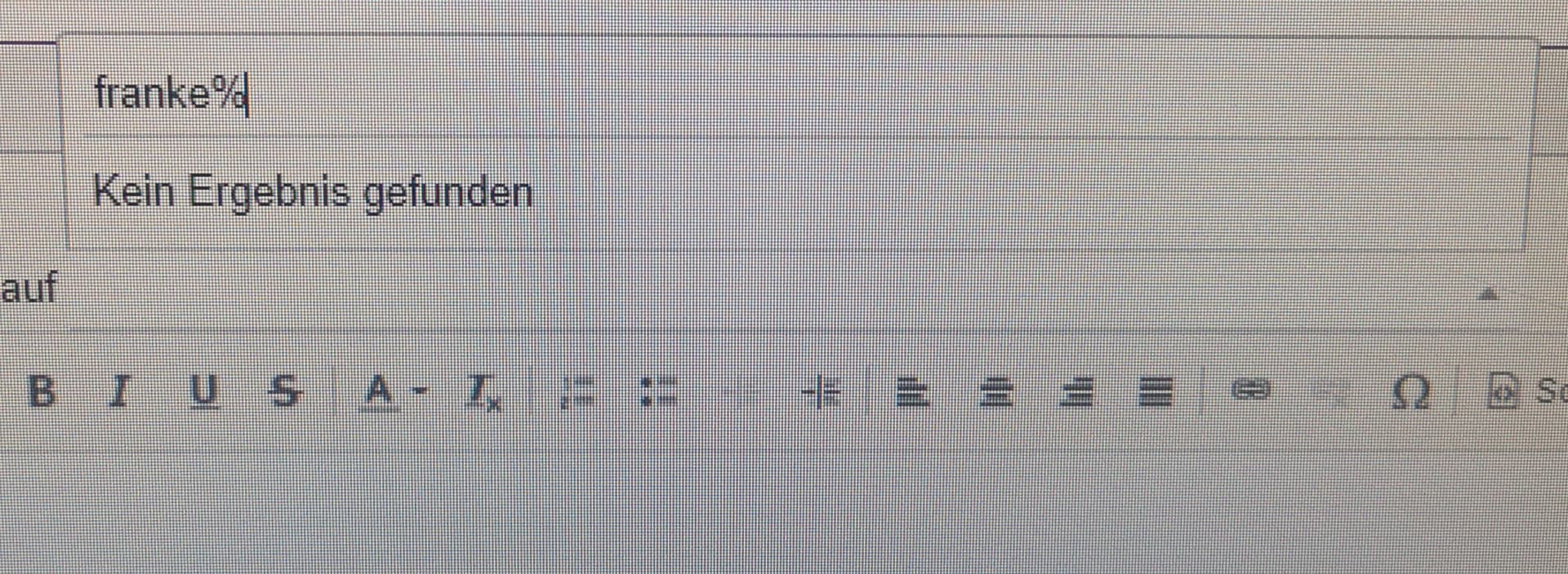

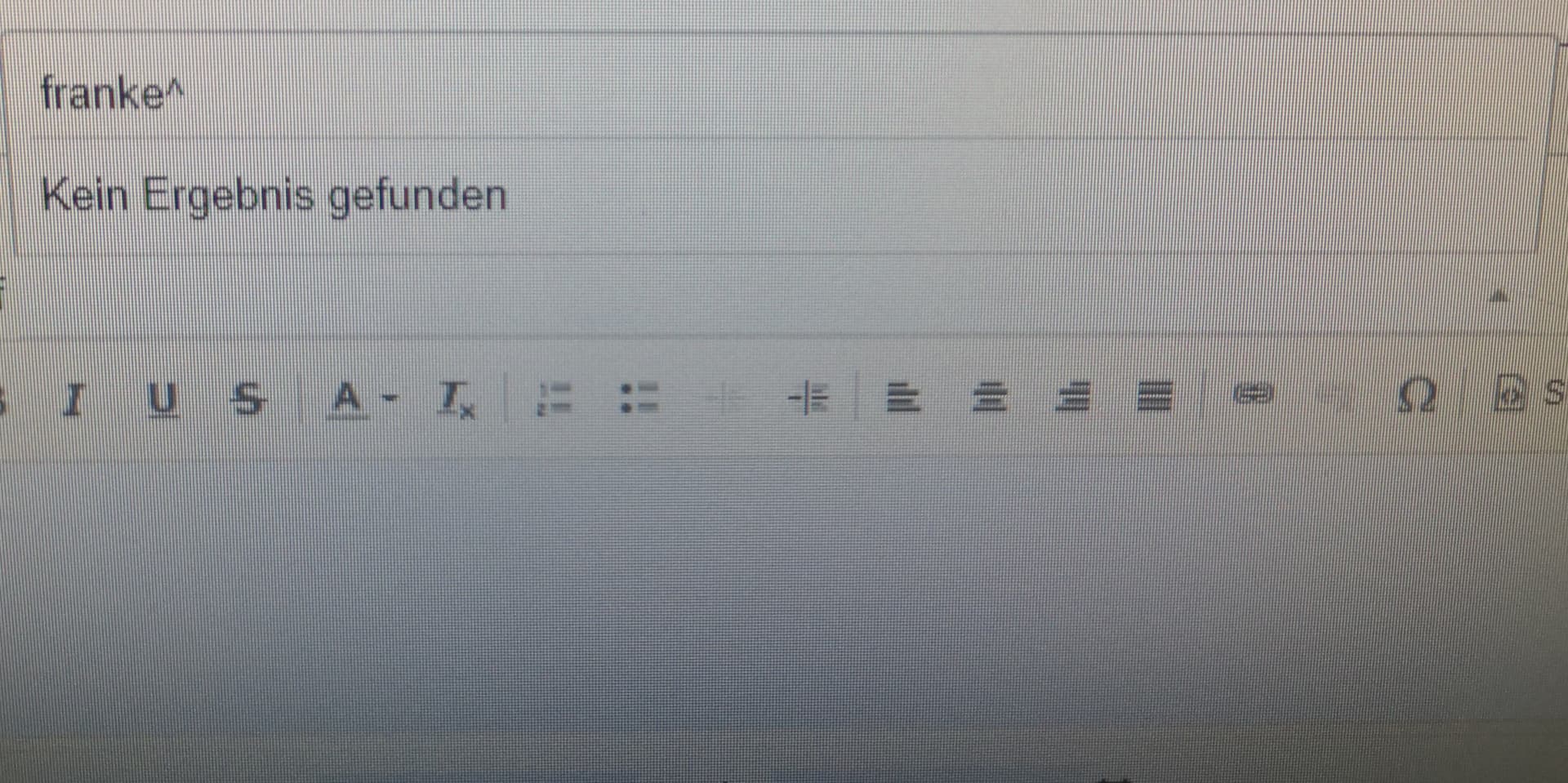

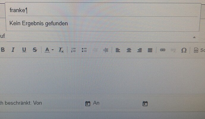

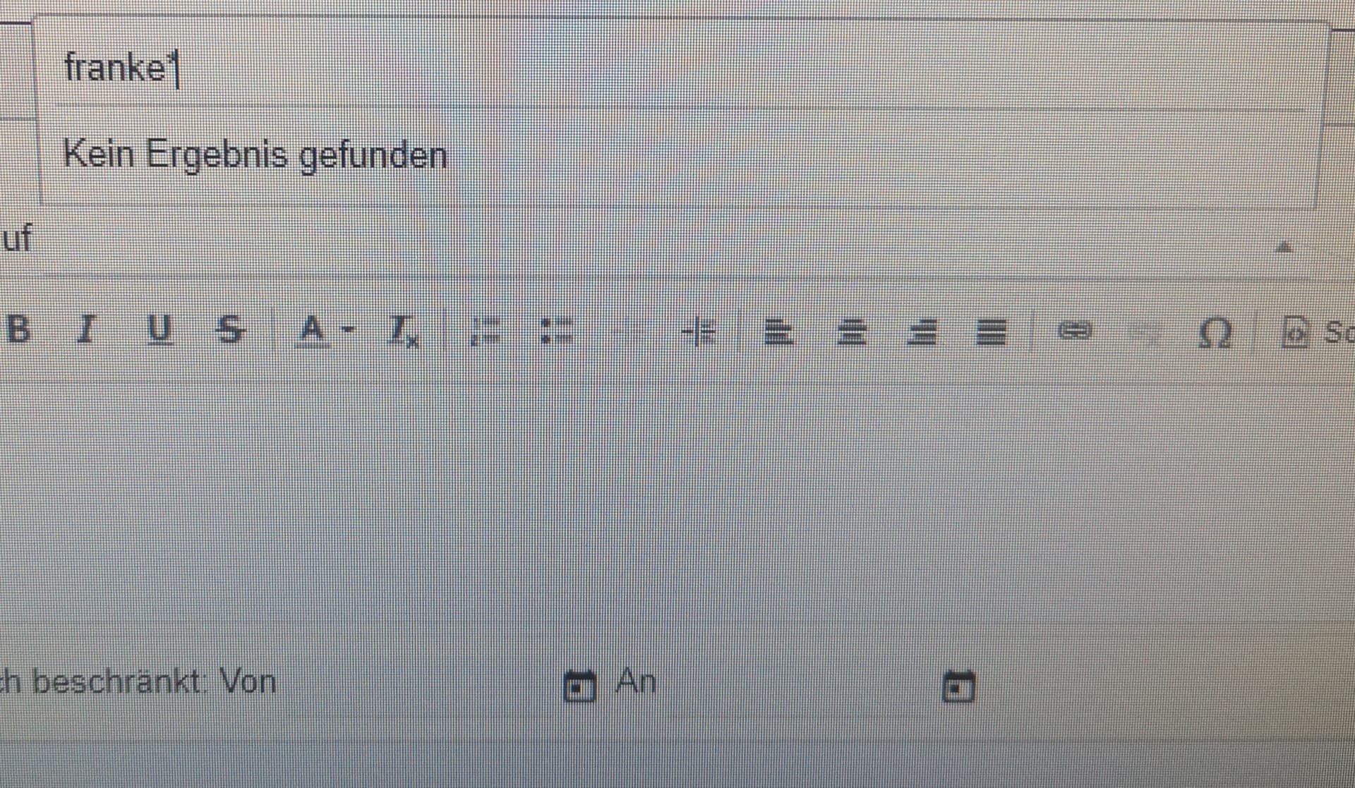

I have the same problem here (See images) … I can start search a product “Franke” and then I need to further dig into the product details (eg. Franke* Flugloch). But no wildcard deleminiter is working ("%" or “*” or “^”). As soon as I enter a wildcard deleminiter the search goes “blank” and tells me “no product found”.
Am I missing something (user fault) :slight_smile:
Thanks for your help.
Chris.
Hello
“franke%flug” might give the results, may be it depends of your dolibarr’s version
on online demo, you can test this :
Good continuation
Nope it does not work for me
Version: 14.0.0
Do I need to activate that specific feature with a variable?
and what is the result with “franke flug” ?
as shown above
“No Result”
I start to type and when typing “%” the results jump to “no results”

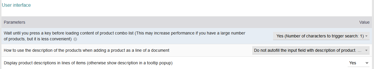

Can you try this configuration for product module…
THAT did the Trick!!! Thanks a lot for your help!
