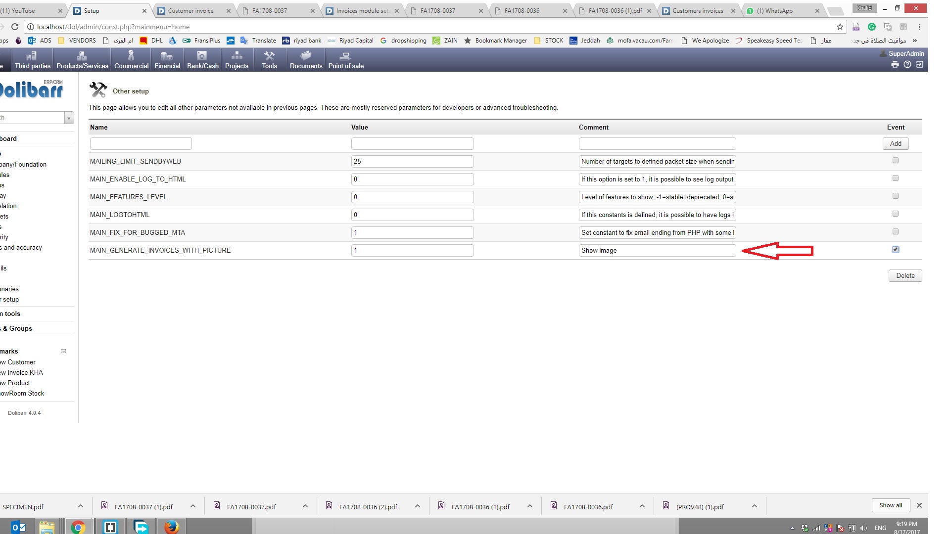

I would suggest using UltimatePDF module for it. It’s a great module that will help you to add pictures and customise your documents in the way you want. It is definitely worth the price but if you don’t want to spend money and you are looking for a simple solution you can use a hidden option for it.
In your Dolibarr go to
in column name add
in column value add
and column comment is just for your reference so you know what this code is for.
More hidden options can be found here

works for me since v5.0…not sure when I was on v4.0
after adding the next line in other setup
MAIN_GENERATE_INVOICES_WITH_PICTURE Value =1

The product picture does not show up in invoices even after enabling:
MAIN_GENERATE_INVOICES_WITH_PICTURE = 1

I’m using Dolibarr 5.0.5
Try with
PRODUCT_USE_OLD_PATH_FOR_PHOTO
or disable it if it’s enabled
