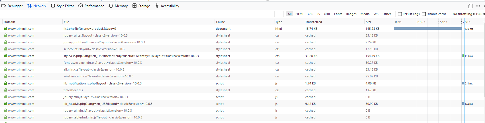

Currently running v.10.0.3, but this problem has been the same on v9.0 prior to the upgrade to v10. When we upgraded from 8 to 9, no issues, but some time during the use of 9 we started having speed issues. We are hosted and installation is through Cpanel on a shared linux server.
Speed for all modules in Dolibarr is great, EXCEPT for when clicking on the left menu (list) or (stocks) under PRODUCTS. I will attach a screenshot, but it always takes about 8 to 12 seconds to display. I have tried turning off the 2 add on mods we have. I have deleted out the few Complementary attributes we have for products, no effect on speed. I have exported products and prices and looked for any illegal characters. I have run repair and optimize on the SQL database.

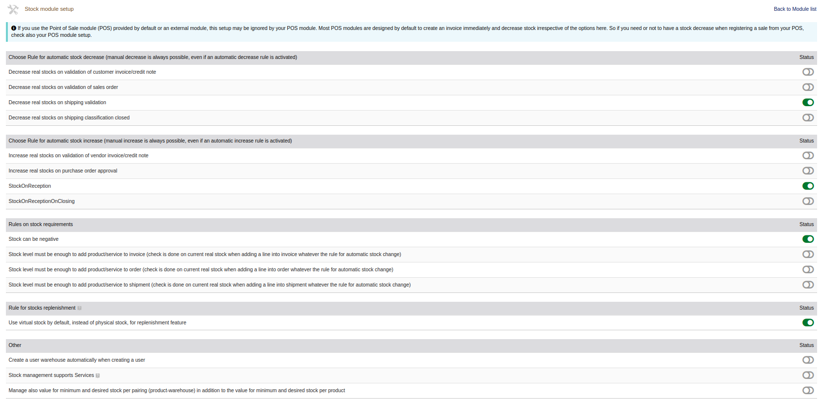

I tried the update to 10.0.4, but not enough speed change to make a big difference. I did stumble across something that at least leads in the right direction. I was turning switches on and off for all modules and found out that when I turn OFF the “STOCKS” module, the Product List comes up quickly. There seems to be no change when I adjust switches inside the STOCKS module itself, so I am left to assume at this point that I have a problem somewhere with the data that the Stock module is reading. The changes it makes in the list when Stocks are activated are:
Virtual stock
Desired stock (we have no entries in this field currently)
Stock limit for alert (we have some entries in this field)
Physical stock (we have entries from purchase orders and inventory adjustments)
Not totally sure where I go from here to find out what is causing it. Maybe a bad inventory adjustment perhaps ??? Your thoughts… ???

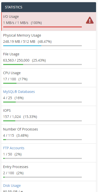

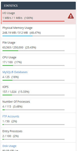

The problem was with our hosting provider in the way the hosting is configured. They had a file in which data is moved during processing information from the database called I/O USAGE. This is set to 1MB and was causing a fault when we had to many people accessing data from the Dolibarr database. The fewer people we had logged on, the less often it would fault. They do have other plans that offer a larger I/O USAGE size, but there are limits. I also had upgraded to v11 thinking this may help, but made no difference on this hosting provider. I have attached some screen shots of a 4 hour session log that shows what was happening, which would freeze Dolibarr for everyone at various times.
So I solved our problem by setting up a Ubuntu server here locally in our office and it is running very fast and with no lag even with the Products List. (even with Virtual active on screen). Response time is milliseconds for all users. :slight_smile:

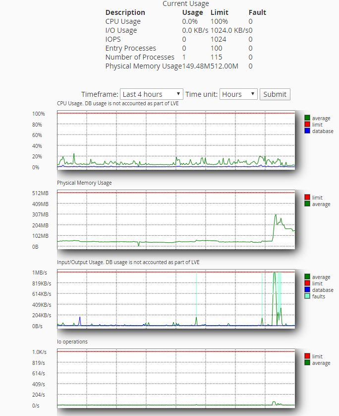

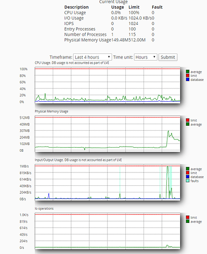

(Old stat files attached below)
