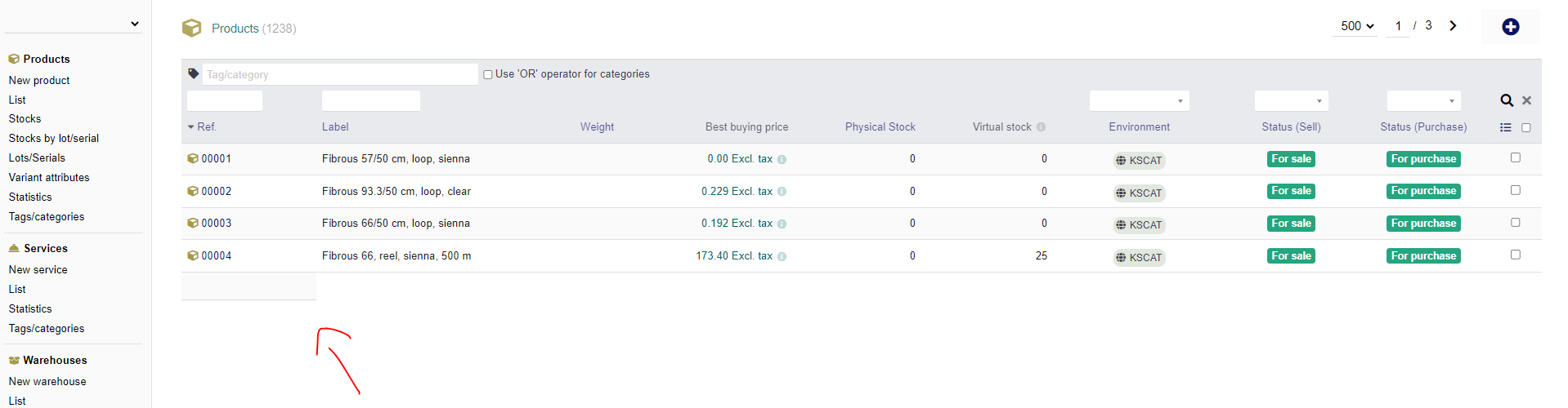

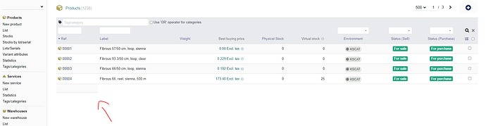

Hi Everyone,
V17.0.0, product list isn’t shown complete. Any idea how to fix. the workarounds didn’t
help.
This problem came from one to the other day without changing anything. Around 14 days ago.
thanks
Albi
First : Update to V17.0.2
Second : PHP script seems to stop before the end of the page => Have a look on PHP logs.
Hi Ksar,
it’s just weird because im using multi company and in the other two entities there’s no problem, only in the main entity.
another problem in the suppliers invoices, i dont see the action buttons anymore. Can’t validate it.
I have no idea about the script, have to read first.
regards
Albi
May be you should ask Multicompany support.
Hi Ksar,
we deactivate Multi company but still the same. Anyway thanks for the tip will try with them.
regards
Albi
