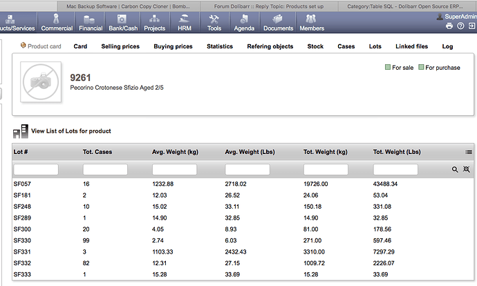

Thanks for your answer. It could work but the problem is that the number of cases is huge compared to the number of product (see attachment)
. So , the list of products is not easy to manage.

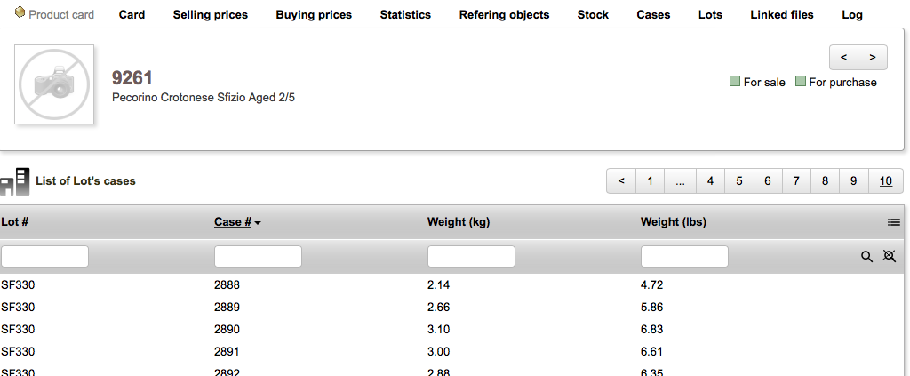

For now, I decided to develop a specific module to handle this. It works (I added two tabs to products (one with cases and one with lots), using a new table for cases and a view to join cases and lots).
