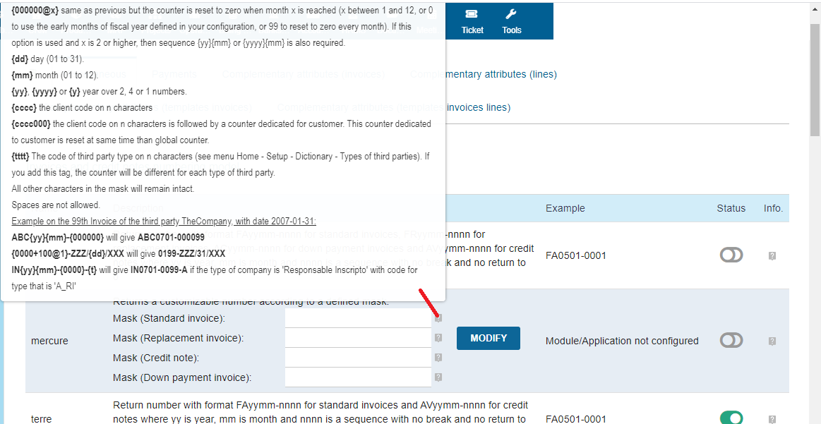

Hi Arisnik,
Please refer to the screenshot below for customization of invoice numbers. You can reach this link from Setup>Modules/Applications>Invoices>Miscellaneous
From the screenshot, there is only customer code can be appended but not customer name.

Thank you for your answer,
but i don’t want to modify the numeric part of the invoice. The solution you propose will be great if there was a way to add the RefCustomer field to the name of the invoice.
Please refer to the picture. Except the cccc customer code, if you want to add any other field, you may need to customize the PHP code either by yourself or through a dolibarr partner.
