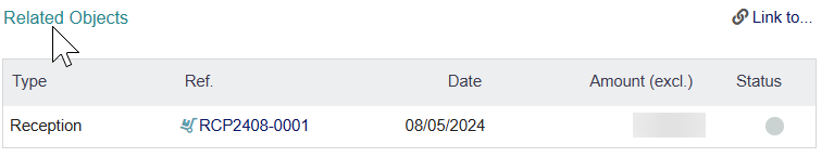

Concerning your question about the invoice after the receipt. A “Goods Received Note” is automatically created, the next natural step would be to pay your invoice; therefore, Dolibarr asks you to create a record for it.
You can find the GRN under Products->Receptions->List, or if you go to your PO, at the bottom of the page you can find “Related Objects”, the file name usually has the name “RCPYYMM-####” unless you changed your settings.
