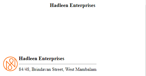

how to remove above company name which without logo
pos setting—>preview
