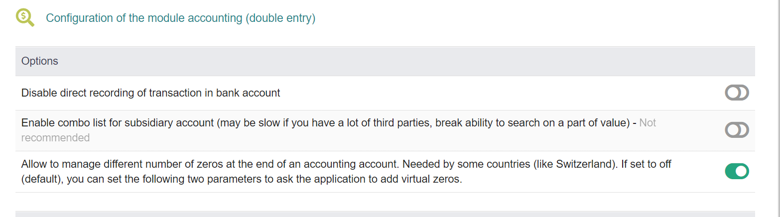

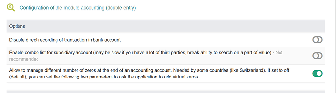

SOLVED! I found this!
This is not in the module setting for double entry accounting, but under accounting in general setup!
