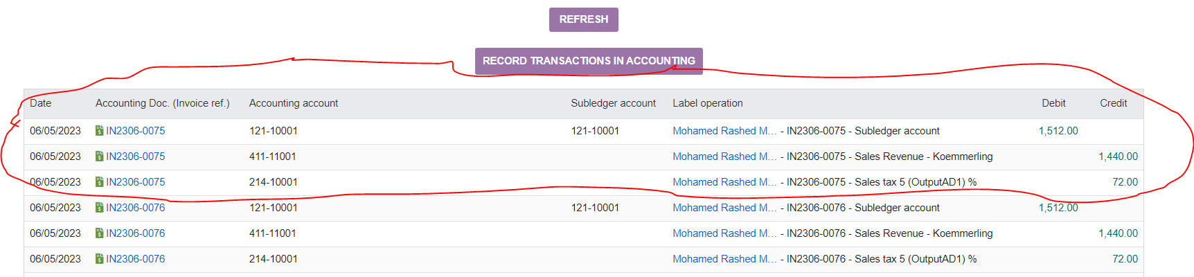

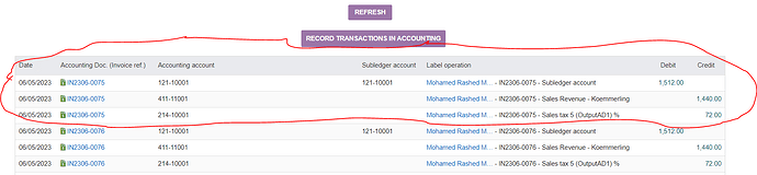

@eldy , I have an actual case here: Inv# IN2306-0075 was abandoned or cancelled (the one with encircle); and replaced with the correct Inv#In2306-0076 - both invoices with same vales and amount… the scenario both mentioned invoice were included in the customer invoice binding, and now included in the record transaction accounting… and supposed to be Inv#IN2306-0075 (abandoned) should not be included in the ledger. What steps should be done:
1). Proceed in record transaction in accounting > both mentioned Invoices.
2). Then, create credit note for Inv#IN2306-0075 then ; so that it will create corresponding entries to offset the cancelled Inv#IN2306-0075
Thank you very much ![]()

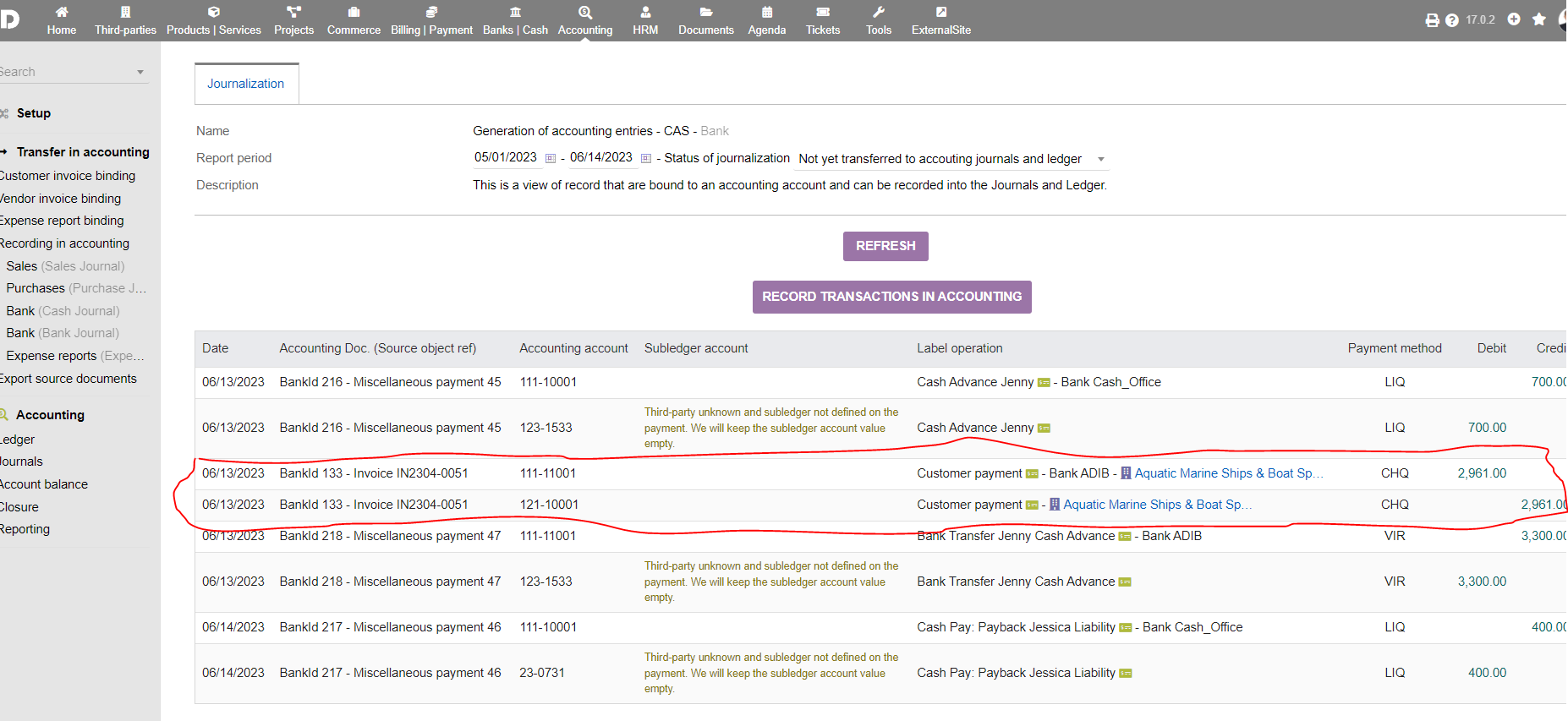

@eldy Hello… Just sending screenshot of my actual case: Scenario is one pdc payment already recorded before (previous month) and due for deposit Jun 13; and it so happen that I have some Miscellaneous payment and ready for record transactions in accounting.
my question is: when i view the bank journal then > record transactions in accounting … previous pdc booked which is due for deposit was already included in the list of record transactions… is it possible not to include “temporarily” the pdc payment previously booked (the one encircled) with the other journal entries that i need to record transaction in accounting?
@eldy I already created a separate temporary account for cheque clearing and other credit account to be used in Miscellaneous payment section other than cash account. ![]()
