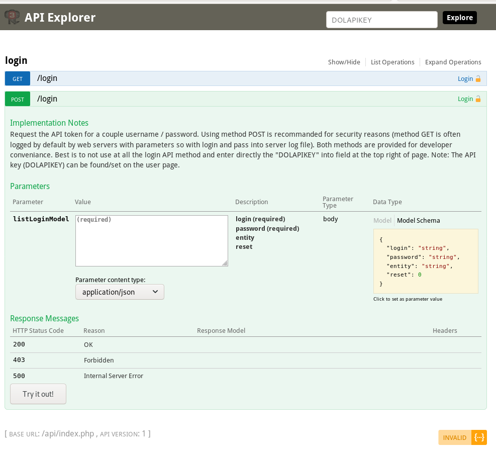

But the request will take me to the Login page and will not respond with the Key that is needed for the
http://localhost/api/index.php/explorer

Normally the login operation is always available in the explorer, even if you don’t have a key (because it is the one that gives the key). Can you try it from there?
Hi! the API Explorer always takes me to the login page. I tried in version 11 and 12 with no luck. The REST module is the only module needed for this to work?
