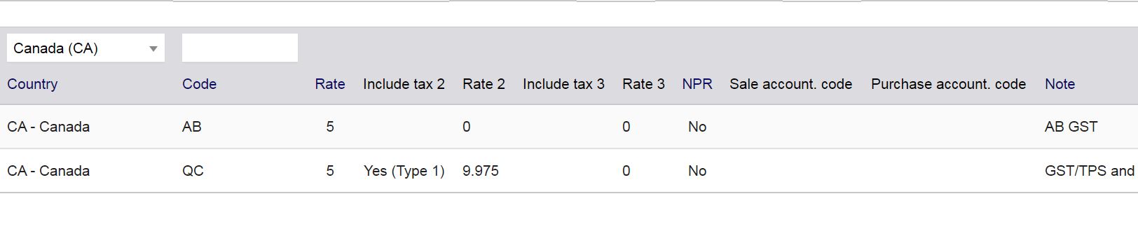

I have setup the tax rules under setup dictonaries.
When setting up an invoice I would like the correct sales tax amount to be auto applied to each product line item based on the buyer’s province. Sales tax differs by province in Canada. By default it is leaving each line’s sales tax field blank.

If just option 2, I don’t see any way of adding a custom country. Could you reply with step by step instructions? Below is what I have in that area so far. much appreciated.
