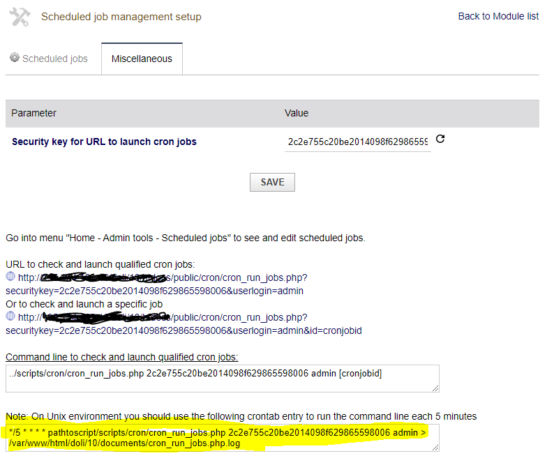

On the parameters you have the code to be put on the crontab on your serveur

Ok, that makes sense now. I have everything set up, I just need to add the crontab entry to run every 5 mintes. Thanks!
