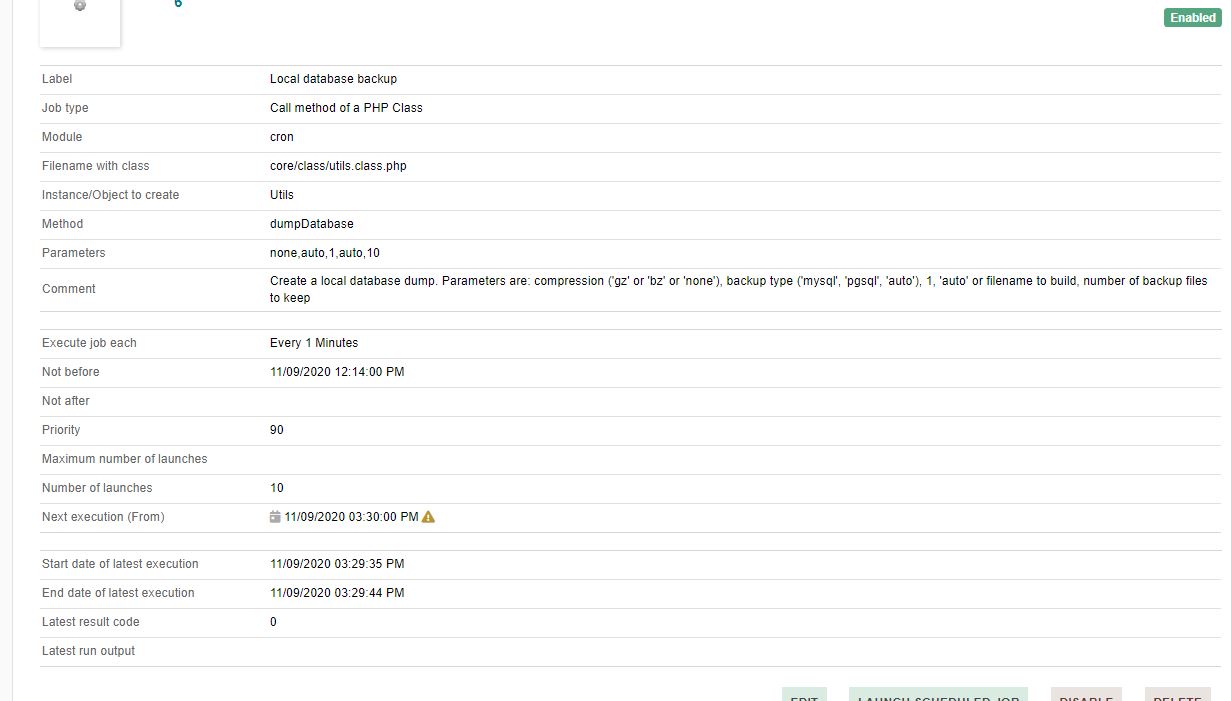

I enabled Local Database Backup which is a built in scheduled job in Dolibarr 12.0.3 which is disabled at the time of installation. I am manually able to click run and the job successfully runs and saves an SQL dump.
However, when it is scheduled to run,
I get [09/Nov/2020:15:07:13 +0300] “-” 408 - in apache server log whenever a scheduled job is triggered.
How can this be solved?

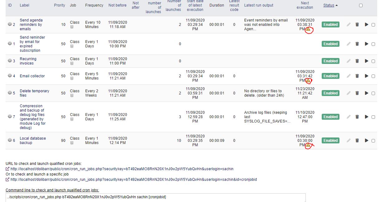

Please see the screenshot. Notice the icons after scheduled time is triggered.

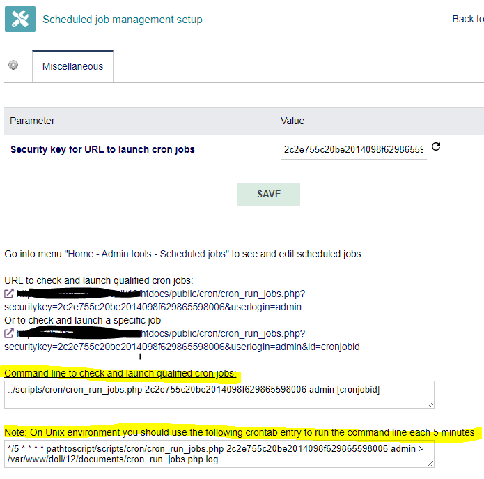

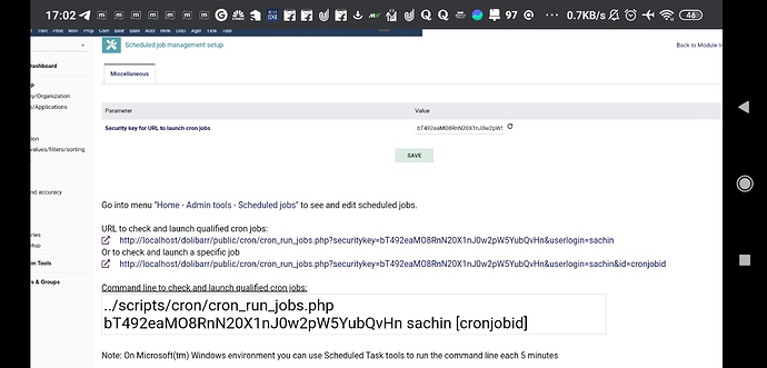

I believe you are referring to this -
Command line to check and launch qualified cron jobs:
…/scripts/cron/cron_run_jobs.php bT492eaMO8RnN20X1nJ0w2pW5YubQvHn sachin [cronjobid]
Note: On Microsoft™ Windows environment you can use Scheduled Task tools to run the command line each 5 minutes
Which php file should I call every 5 mins?
