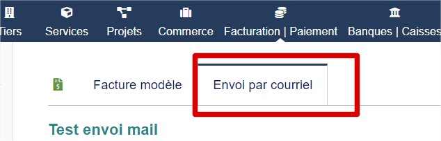

I started investigating and noticed that I no longer have access to the “Email Sending” page for each template invoice. I checked the “custom\sendrecurringinvoicebymail” directory in my new Dolibarr installation, and it was empty. Therefore, I have copied all files and directories from my old instance to the new one. This allowed me to regain access to the “Email Sending” page (see attachment). However, the problem is not resolved; the email still does not go out with the attached invoice, as it has been working for over a year now.

Facture modèle - Envoi par courriel - Google Chrome
