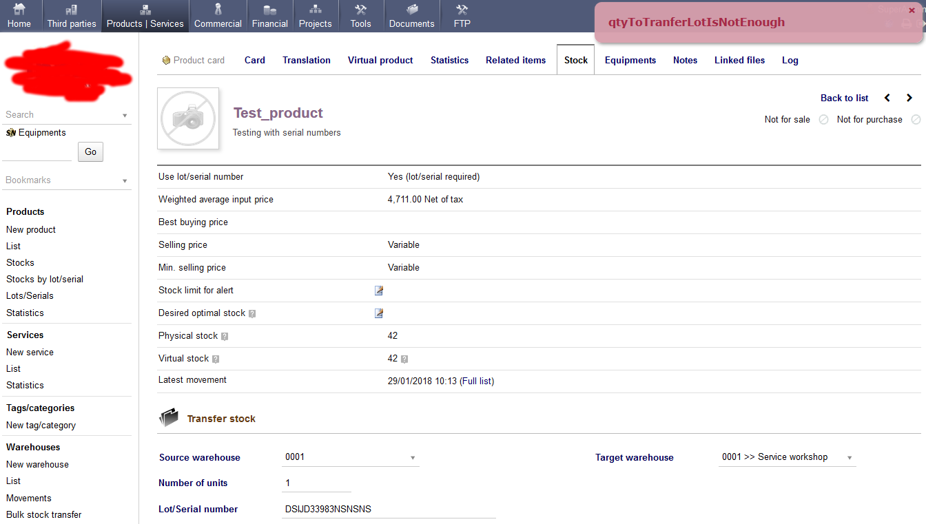

However, this “lot/serial” feature seems to work only on lots and not on per unit. What we want is basically this:
We (a reseller in the medical sector) purchase 20 units of identical tools (medical machines). We re-sell them one by one to hospitals. Using the units’ unique serial numbers, we want to keep track of its activity. The activity itself can be tracked by moving between warehouses in Dolibarr, but how can we add the units’ serial numbers?
I added 42 test products and added a serial number like “SN-1234-test-XXXXX”. When trying to move /1/ unit from warehouse 1 to warehouse 2, I could enter any new serial number I want, but got the error: “qtyToTranferLotIsNotEnough” because Dolibarr works on the 42 as a lot and not 42 individual units.
So, is a serial number tracking system like this achievable in Dolibarr, or do we need to find another solution? The best thing is if we could keep everything within Dolibarr.
Pièces jointes :
- Untitled.png (59.6 KB)
