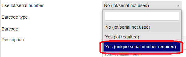

Did you set your product as this :
I think you can make your purchase order without serial numbers
But on reception you will be able to indicate each serial number
Good continuation
I use the latest version. Product set as you descripe.

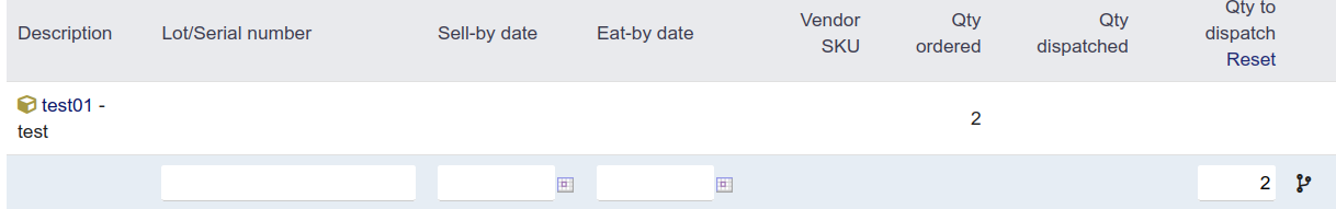

Do you have a screenshot maybe. I only see one input field.
Hi
When you click " CREATE RECEPTION " , and you will see as below .
Then you will need to input firstt serial number and change the Qty to 1 (If you purchase two of this item . ) .
Then click image to create second line , then input second serial number .
Thank you very much!
