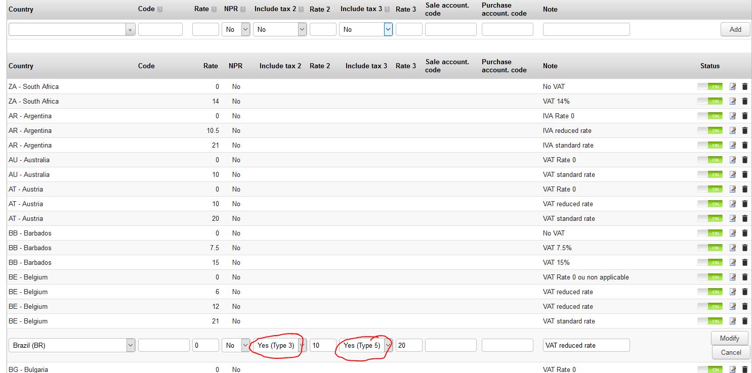

You can try this:
1 - First you need to enable the use of the second and third charge … I do not know why but it is enabled only for SPANISH companies !
2 - in screen “Seup-dictionaries-VAT Rates” must enter the VTAX and ISS respectively as the second and third charge, leaving empty the VAT field. The tax imposed VTAX as 2-Type3 (only on products) and the ISS as tax3.type5 (only on services).
3 - in the screen “Setup-Company” the ideas box “VAT is not used”
To enable use of the second and third charge there are some substitutions to be done in code.
You should download the “TextCrawler” program with which you can do a text search the entire directory of Dolibarr and replace all strings containing '=“ES” ‘’ with '=“BZ” ’
Pièces jointes :
- 1.jpg (111 KB)
I did not make it.
