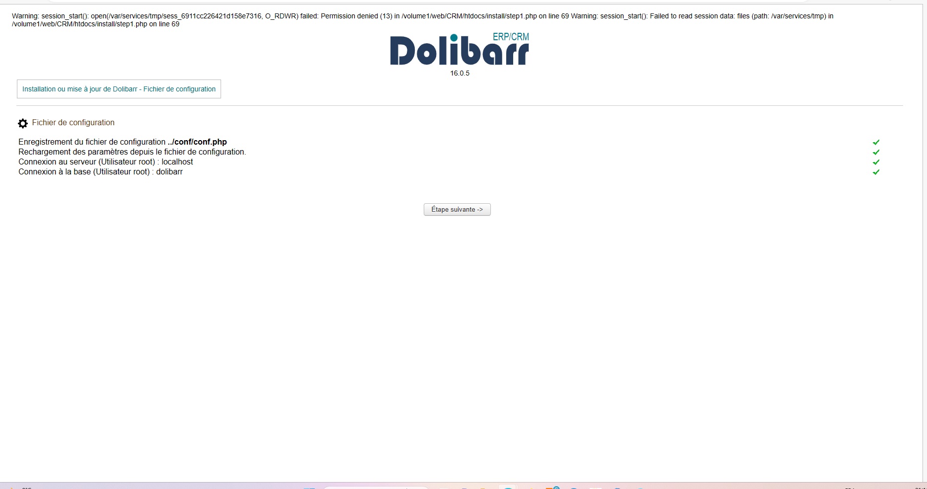

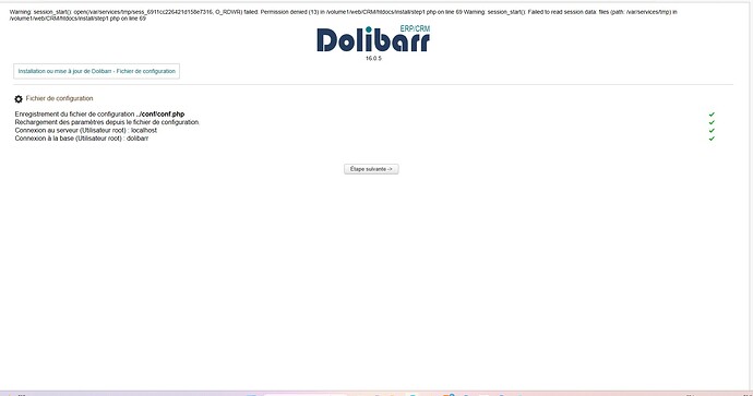

I encounter a problem when installing dolibarr on my NAS Synology DSM7.
Here is a views of the installation and error messages. The result gives me a 504 error code.
Could you help me to solve the problem?
THANKS
You have an issue with you PHP session.
The folder ‘/var/services/tmp’ can not be written by PHP or do not exist
I don’t find that “/var/services/tmp”
nor even “/var/services”
how and where should I add it?
Thanks
Better to ask Synology forum.
But the setting of the PHP Session directory should be : https://kb.synology.com/en-vn/DSM/help/WebStation/application_webserv_php?version=7
Either you change the PHP Session directory setting to an existing directory or you create “/var/services/tmp”

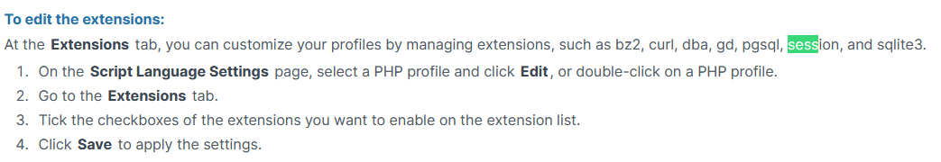

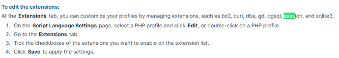

Having succeeded in my installation and if someone encounters the same problem as me, here is a modification to be made in addition to the “Timeout” already filled in
Thanks for @ksar helping me solve my problem.
