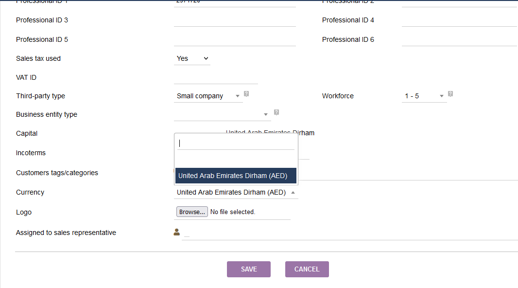

I have tried that but on the Customers Setup Currency only one currency to be choosen on the pop up menu

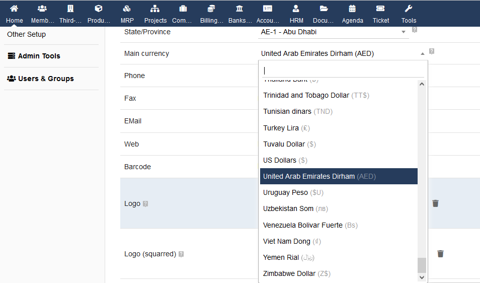

On the company’s Main Setup it does work

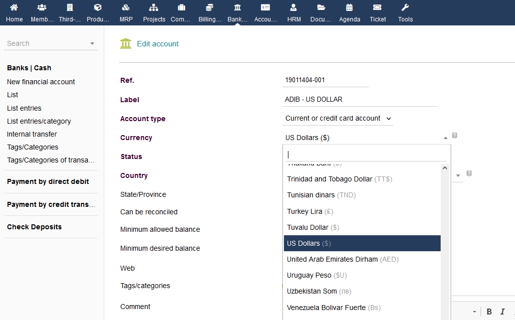

On the Bank Module it does work

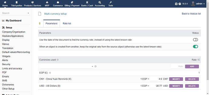

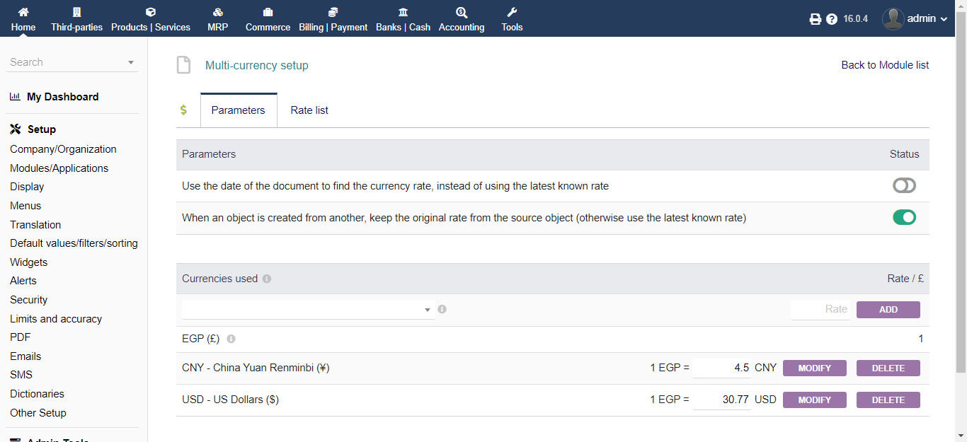

it is very easy to solve. the thing is you just need to add the currencies you use to the system.
You can use the multi-currency module available for free.
You will find it on Setup > Modules/Applications > multicurrency > Settings icon
then add all the needed currencies.
