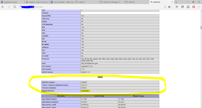

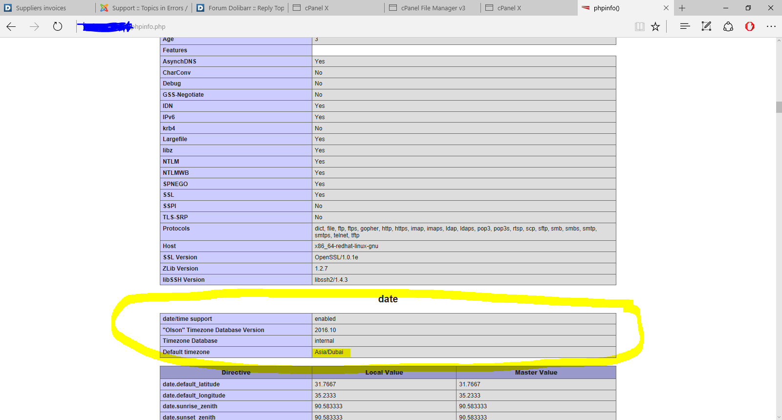

I did the same. in php ini I have added
date.timezone=“Asia/Dubai”
then I have created a php script in the root directory of my webserver with the following content.
<?php
phpinfo();
I named it phpinfo.php
then I called it throu the browsers and got correct valued=s from server.

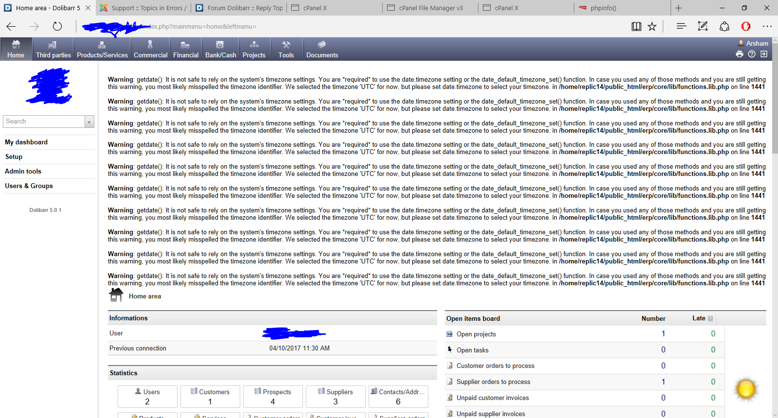

as you can see everything is ok. but I still get
what to do to solve it?
please Help

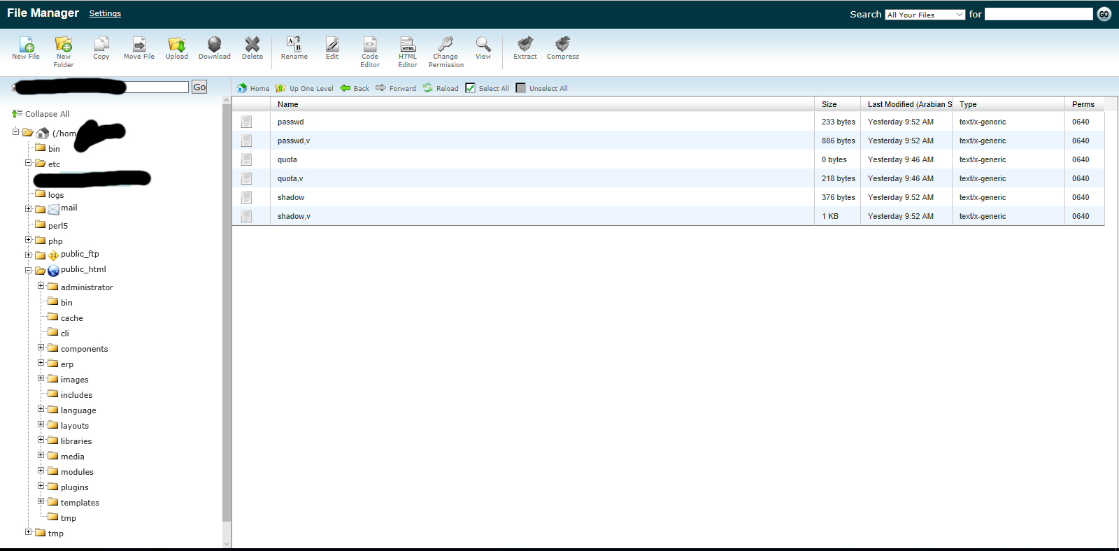

You probably not edit the php.ini that is used by apache.
Check into dir /etc/php5/apache/
where is no such folder.my /etc/ is empty. and /php/ is in same directory as /etc/
php.ini is in public_html.

from Dolibarr About PHP menu, I can see that php.ini has been loaded from /opt/php56/lib/php/php.ini
I don’t have this directory. or file

before fixing with above method I checked with phpinfo() function and Dolibarr’s Admin Tools->about PHP menu.
both returned different values for Loaded Configuration File.
