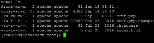

I am new to Dolibarr but not to web servers nor Linux so I know my permissions are right but I still get this error on a fresh Centos installation.
My config.php is chmodded 666 and the ownership is correct (apache). In the screencaps attached the pre-req check has a green tick but still says “Configuration file htdocs/conf/conf.php is not writable. Check permissions…”
What else could it be?

Hm, ironically, I have a working version of dolibarr on ubuntu and went with centos on another machine.
And I have this issue.
On Centos 7 Selinux is disabled by default… So nothing to touch with that.
For the writable conf.php file, did you try this? ->
From Dolibarr root directory:
chown -R apache.apache htdocs/conf/conf.php
chmod -R 755 htdocs/conf/conf.php
Also don’t forget to set conf.php to 644 or 444 after successful install (to stop security error warnings once logged in).
Hope it helps.
