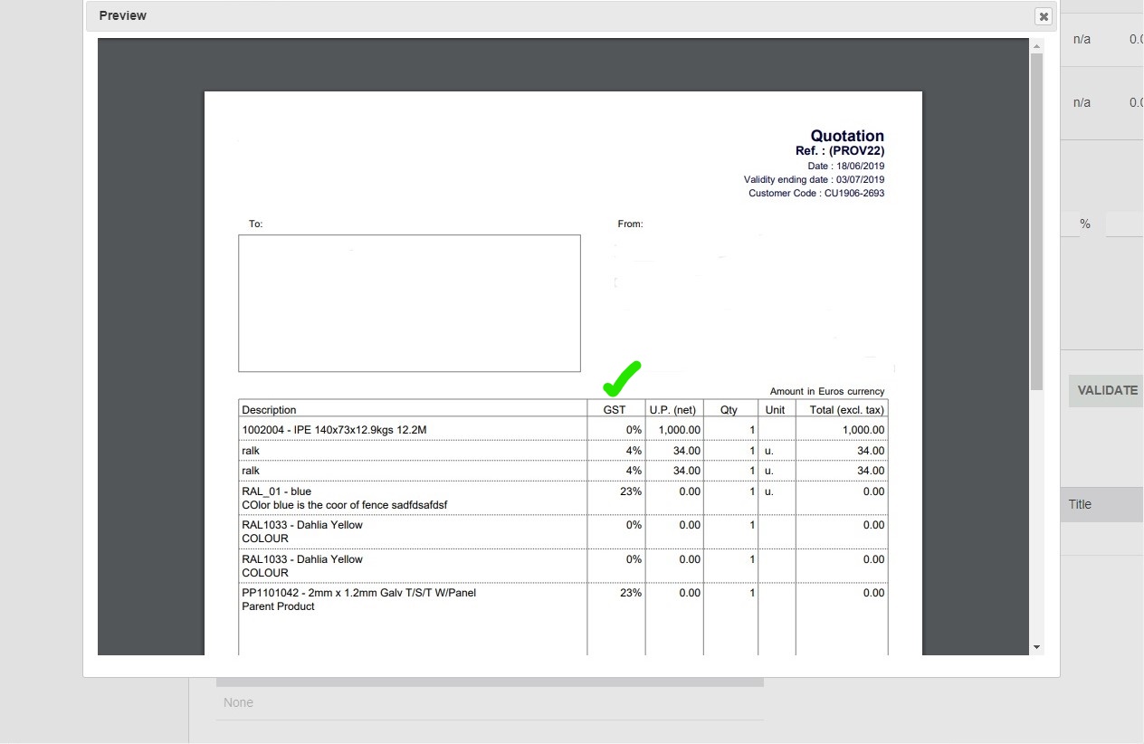

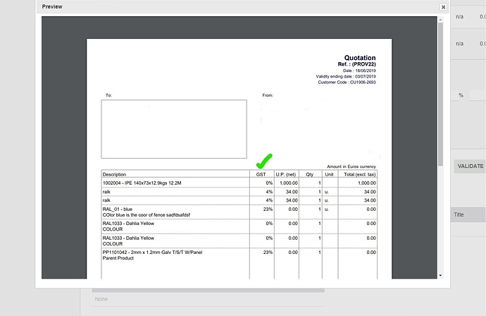

In PDF change Sales tax to GST
On the Setup -> dictionary you can change the textes.
On the Setup -> dictionary me failed to find text setup pls help
Muhammed Ikka, ithano vendathu ?
Is this the way you wanted ?
You could change it in Translation.
Check Home->Setup->Translation
its done.

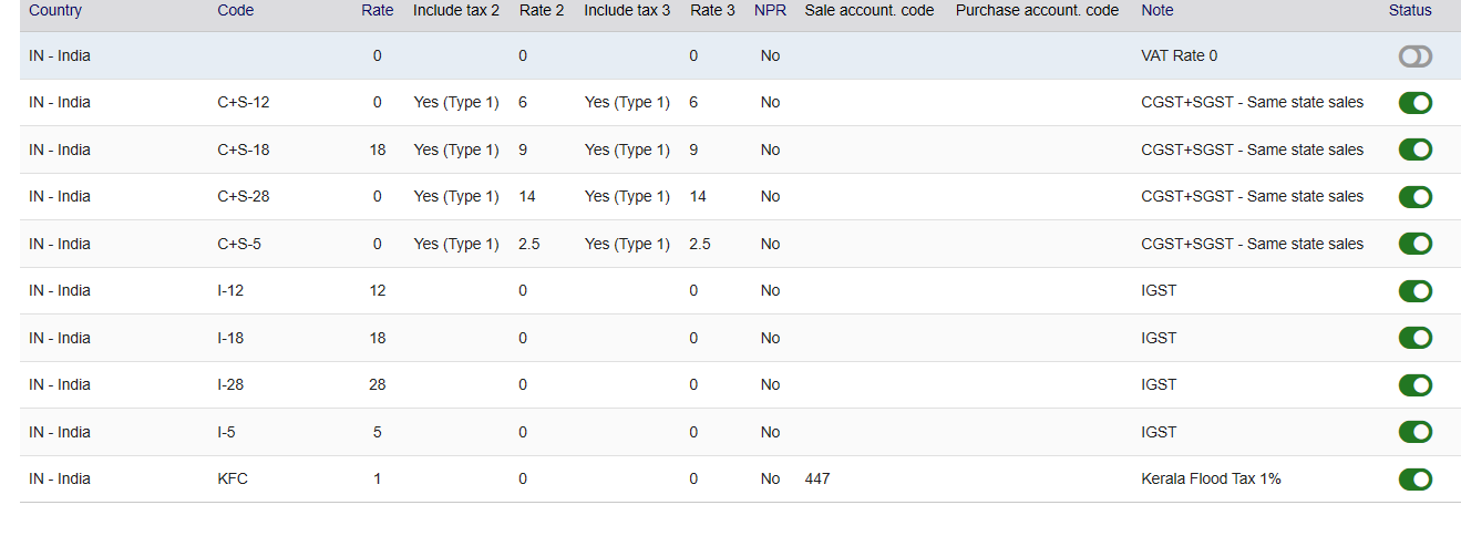

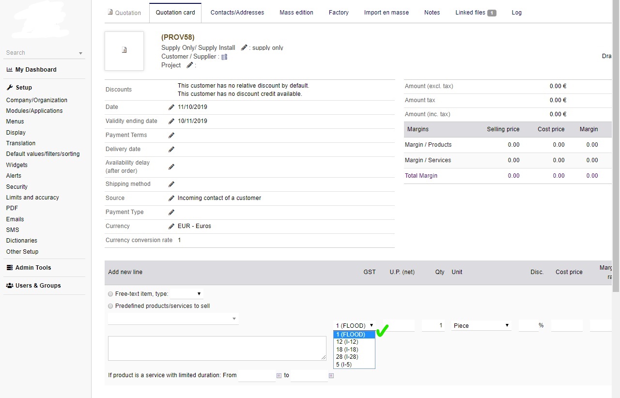

can you help me to add kerala Flood Cess 1%

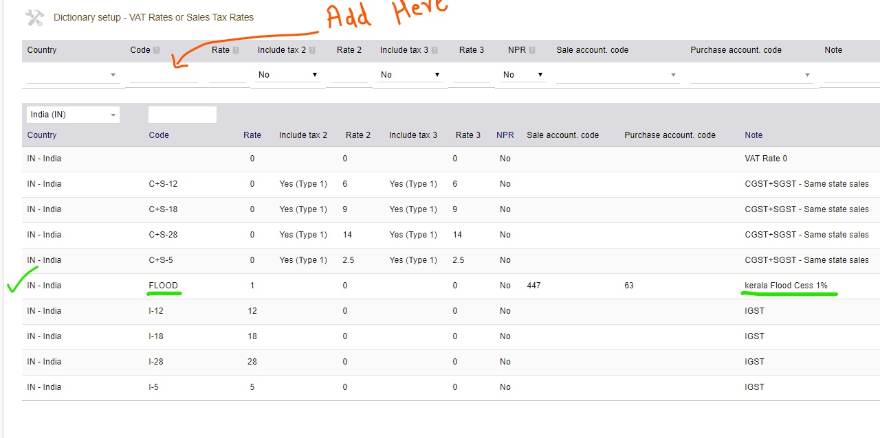

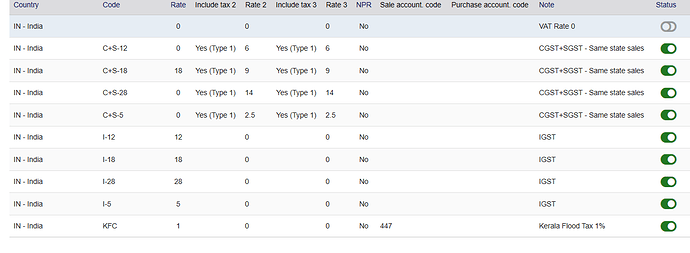

Home-Setup-Dictionaries - VAT Rates or Sales Tax Rates
can you provide some explanation pls.

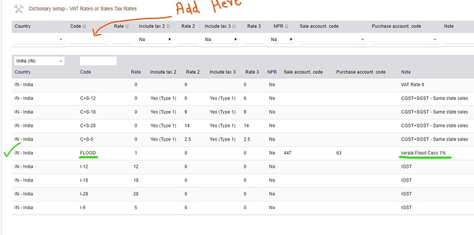

Hi Muhammed,
  1. You can go to Home-> Setup-> Dictionaries -> VAT Rates or Sales tax rates . Then you can add a new tax rate there. Use the country code -INDIA, code-FLOOD , rate -1%, Add a note - Kerala flood.
  1. Make sure you have setup India as the country in the company setup: Home-> setup->Company->modify->country=INDIA. Then you could use added tax rates from step 1.
Hi Akkz
added flood tax
pls see 2 nd attachment reqiuired

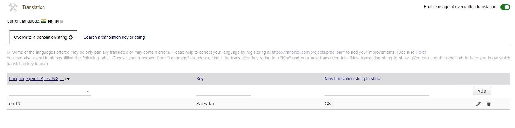

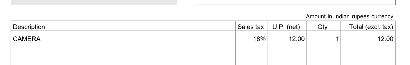

I need some help here. I made the following change and still the PDF output shows only “Sales Tax”. What am i doing wrong ?
Hi
Setup — Translation----VAT---- change to IGST
Thank you very much !! It worked now.
