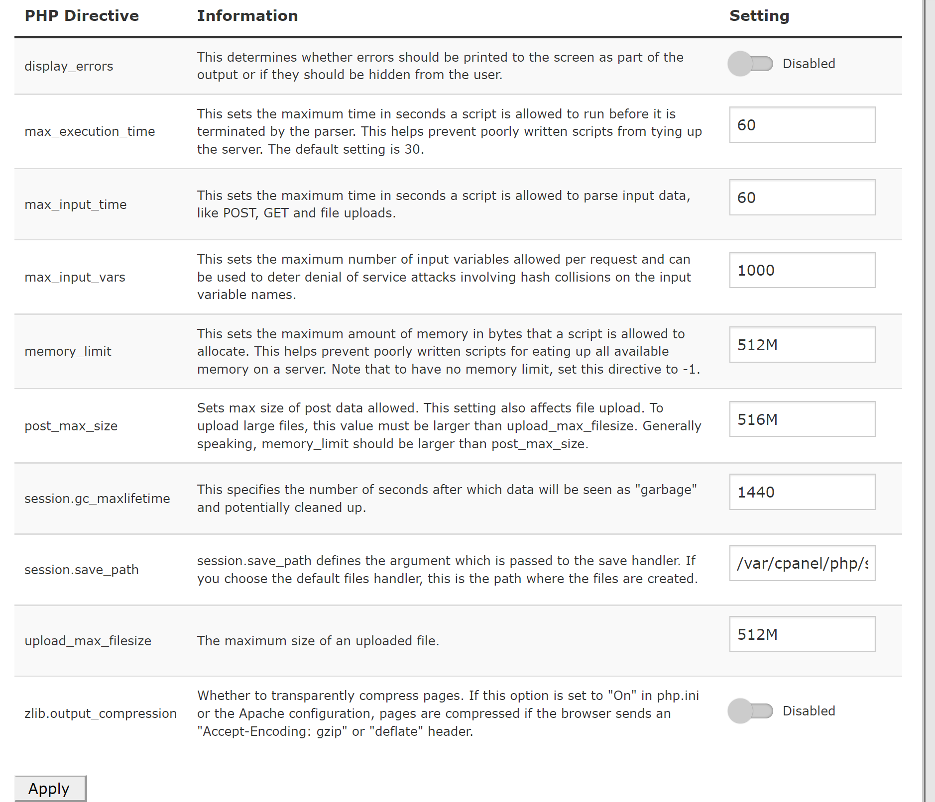

Thanks for the swift response. What exactly could be wrong in php.ini?
As of now there is no php.ini file available in the domain. There is one available to configure & apply in basic mode or to create in editor mode.

You can try to increase max_input_vars and max_post_size
Thanks @ksar
It worked for me.
