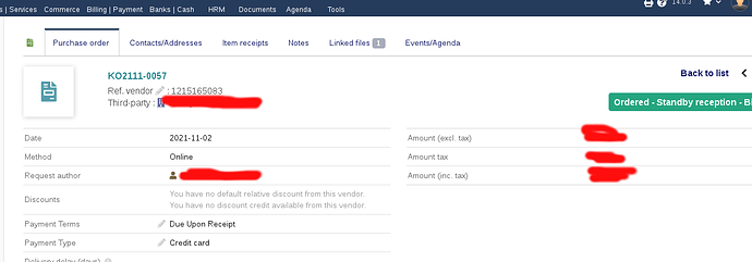

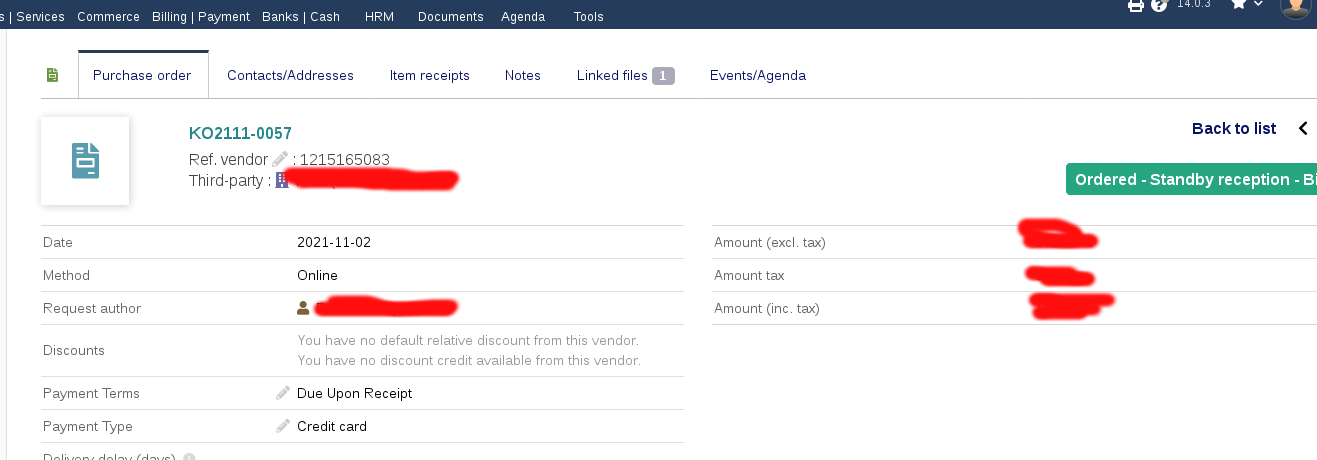

Is there any way to add a shipping card to a purchase order? This way we could add tracking numbers on purchase orders quickly see their shipping status.

Shipment module is enabled (it’s used heavy in Sales Orders) but there is no “Shipment” page under Purchase orders card.

My user (admin) has full access to all modules, I just double checked it. Shipping module for Customer Order works fine, but not for Vendor/Purchase orders. I tried to disable Vendor/Shipping and enable, but still cannot find Shipping card in a purchase order.

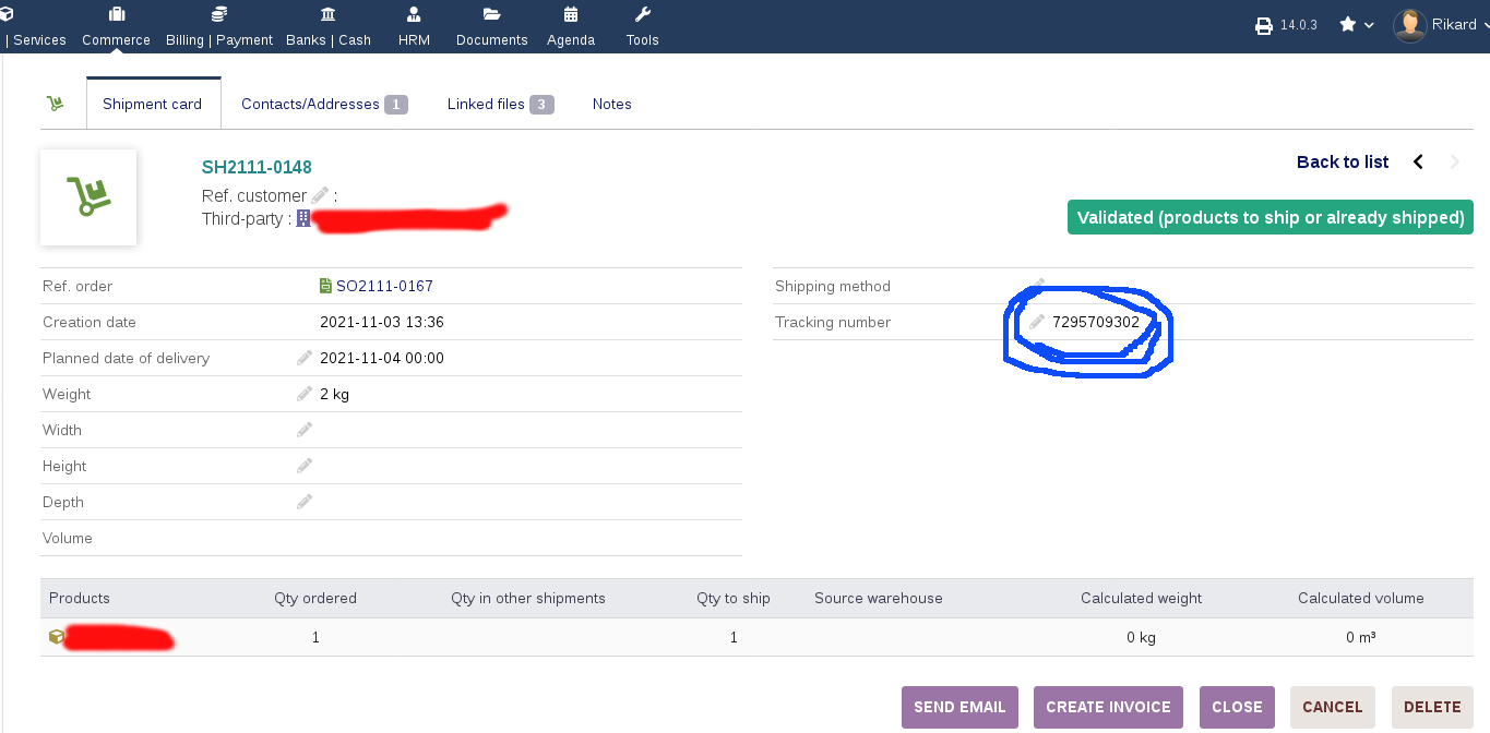

Thanks for the reply. There is a “classify reception” in the purchase order, which we use when the goods have received. However, this is not what I’m asking for. We would like to add a shipment card to the purchase order, so we can add a tracking number to the purchase order, so we can track the shipment before it’s delivered / reception. Just like it works for Sales Orders (see image of a sales order shipment).

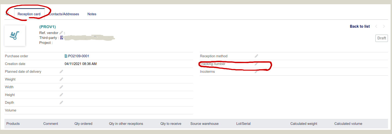

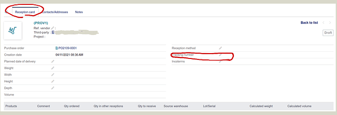

Shipment card is used for you sell product to your customer , and reception card is used for you purchase a product from your vendor .
If you enable reception module and create a reception card , then you will see a tracking number as below .
