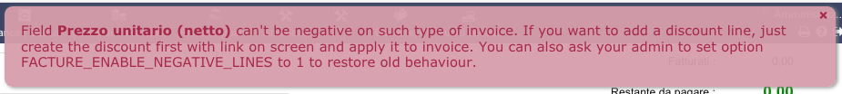

In an invoice, when I try to add a line with negative value, the alert in picture is displayed. I’m using 8.0.3
In previous versions it was possible.

Try:
Home ► Setup ► Other
FACTURE_ENABLE_NEGATIVE_LINES = 1
Let me know if it works and then I will add it to the wiki
Yes, it runs!
Thank you
