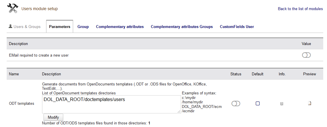

I couldn’t find the option as you suggested as in above screen shot. Could you please confirm: Whether this extra fields provision comes by default or whether we need to install a module
Thanks
Complementary attributes = Extra fields
I just renamed it in my language files.

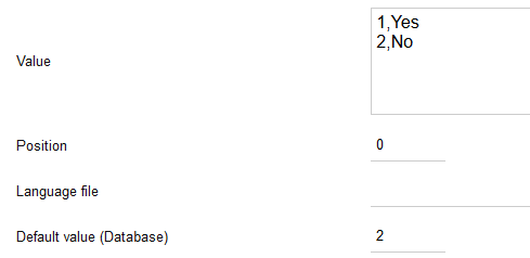

Thanks. This is working. In this I couldn’t set a default value. If I try to set as in below screen shot this error ‘BLOB/TEXT column ‘company_admin’ can’t have a default value’ appears. Please help
Why don’t you make it:
1,No
2,Yes
Default value (blank)
