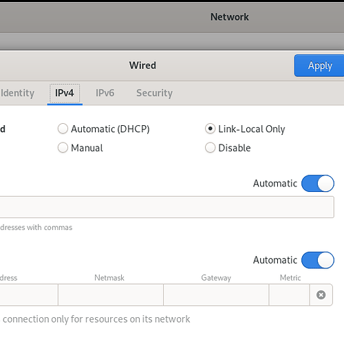

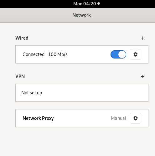

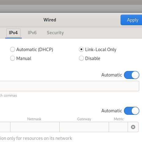

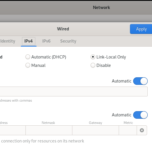

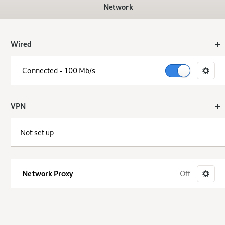

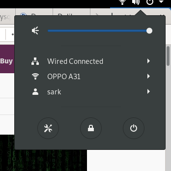

here is my network settings…
COMPUTER A (server)
Screenshot from 2021-03-29 04-09-03 Screenshot from 2021-03-29 04-20-19
COMPUTER B (client)
Screenshot from 2021-03-29 16-19-57 Screenshot from 2021-03-29 16-19-38 Screenshot from 2021-03-29 16-12-52

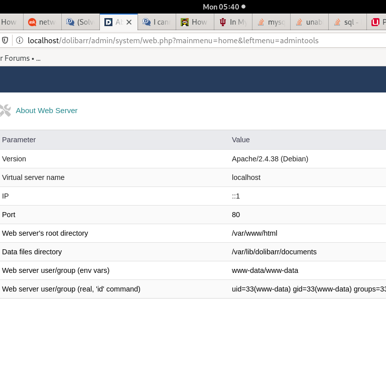

On the server computer, what is the address you put in the web browser to access Dolibarr ?
On the client computer, what is the address you put in the web browser to access Dolibarr ?
It seems a Vhost issue, could explain what do you put for Apache config and on which folder do you put dolibarr ?
please find the below…
in the client, I put http://169.xxx.xxx.xxx/localhost/dolibarr/index
Hej deploy,
as far as i remember the starting folder for webservices under Ubuntu is /usr/www/html. If you installed Dolibarr in a subfolder Dolibarr (so the whole foldername is /usr/www/html/Dolibarr) the user from another computer may get access to Dolibarr via http://<ip-address of the server, something like 192.168.0.100>/Dolibarr/htdocs. If you use a hoster it would be http://www.your-servername.com/Dolibarr/htdocs.
You mentioned that you added the folder “localhost”. That is just necessary if you call Dolivbarr from the computer where Dolibarr is installed. So you call Dolibarr from the Installserver with http://localhost/Dolibarr/htdocs.
What you have to enter as URL in the browser depends on the computer you are currently working on and on which server you install Dolibarr.

you seem to have an IP address problem. According to your log your Apache listens on 169.254…
This is a fallback IP on an unconfigured or not correctly configured interface. It’s configured for DHCP but does not get an IP.
Please try to fix that and post an updated apache log.
