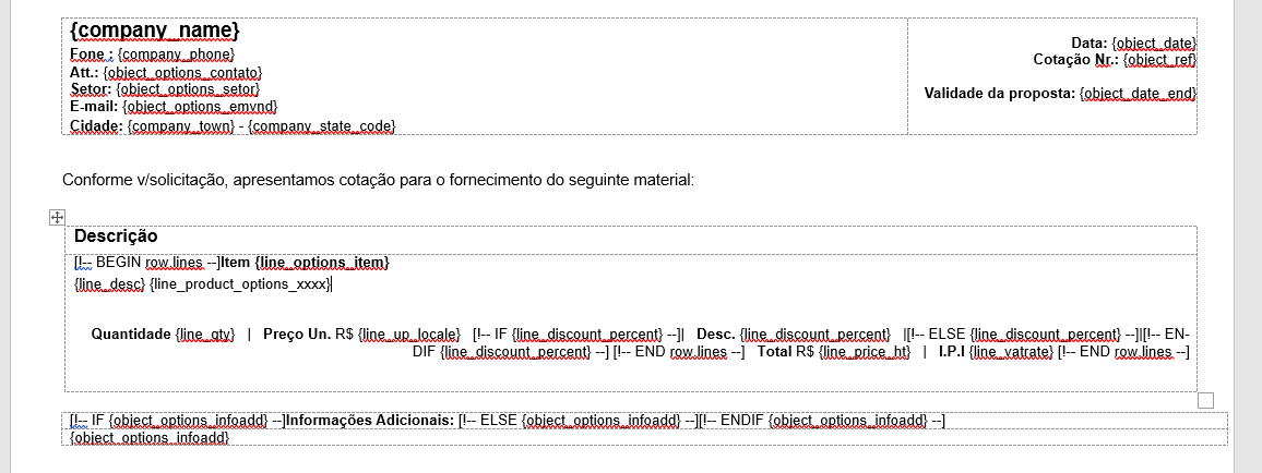

The test I did :
- Create an Extrafield in product.
- fill it for one product
- Use the {line_product_options_xxxx} in Propal ODT
- Create a Propal with the product
- Generate a Propal ODT
It should be the same on Order

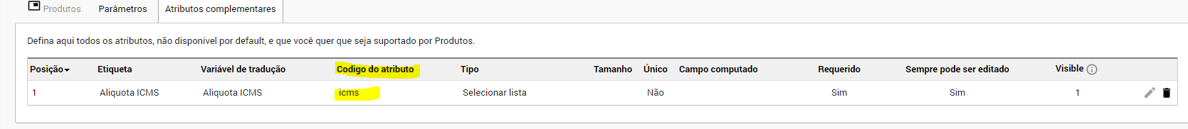

Hey there!
I know this post is a little bit old, but I’m facing the same issue.
the tag {line_product_options_icms} isn’t working for me. I’m using v7.0.2.
I did exactly how KSAR explained on hi comment
The test I did :
My attribute code is icms, that’s why i’m using {line_product_options_icms}.
Any suggestion? I tried many different ways and none of them works!
Any help is appreciated.
