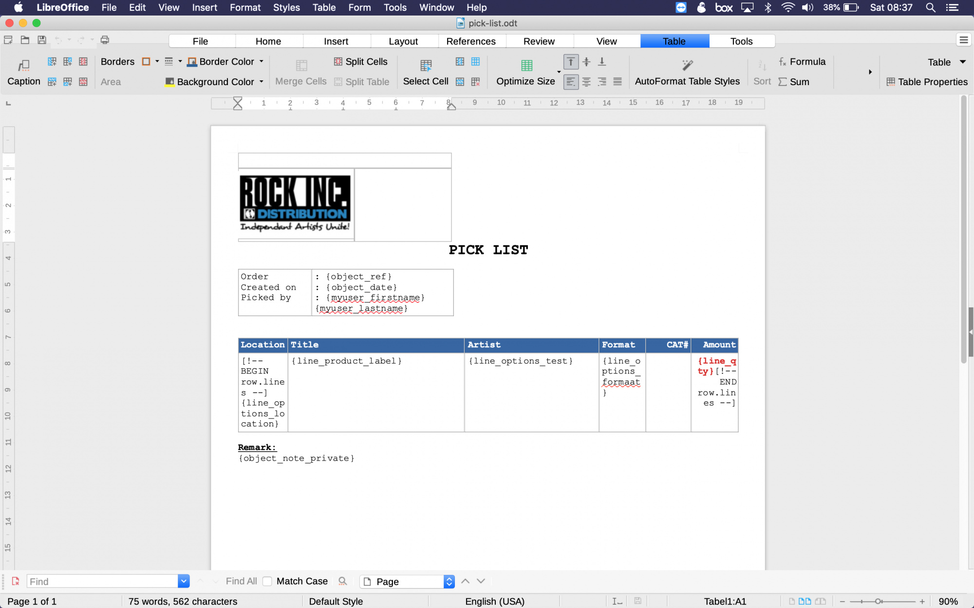

In Dolibarr 8.x the use of {line_options_xxx} in ODT files for proposals, orders and shipment works fine. After upgrading to 9.0.1 none of the ODT templates work anymore.
{line_options_xxx} isn’t filled out anymore

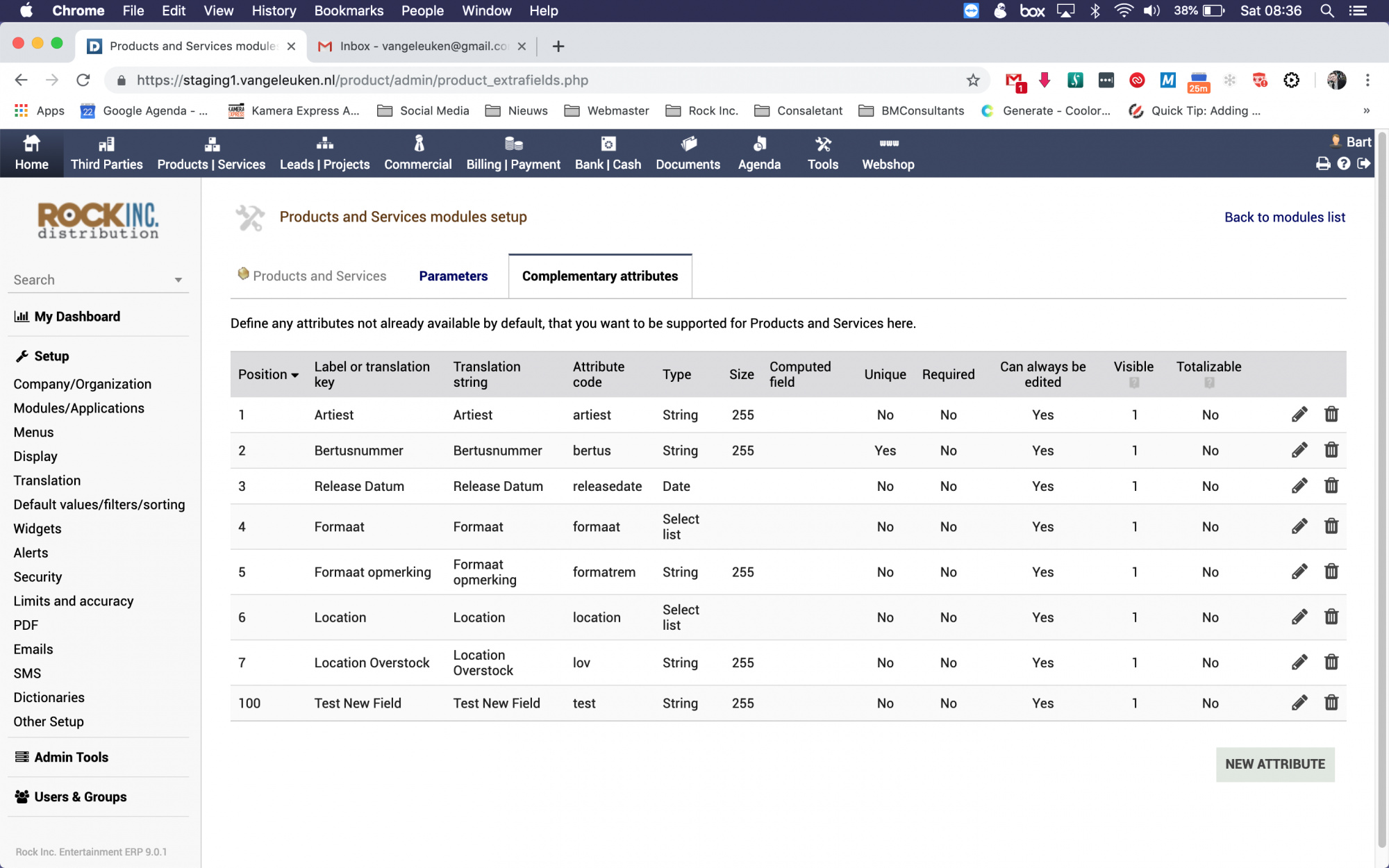

Try testing out by defining a new line options and inserting that field in your ODT. This would at least help in ruling out if the option is working altogether or if there is a bug
THis is completely normal that it doesn’t work.
You have created your extrafield on product.
And you try to display it as it was a line delivery extrafield

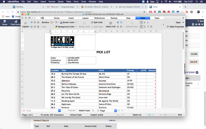

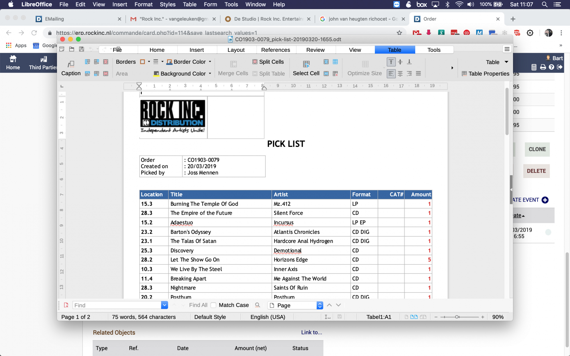

But it’s exactly the same template
But in an earlier reply som e one asked to add a new field and use that one in the template to exclude that it was my extra filed configuration.
That’s why there is an extra field called test and I used that one in the template.
Other than that it is the exact same configuration and template
I change {line_options_xxx} to {line_product_xxx} where xxx is the name of the attribute code --> no result
Then I change {line_options_xxx} to {line_product_options_xxx} where xxx is the name of the attribute code --> no result
