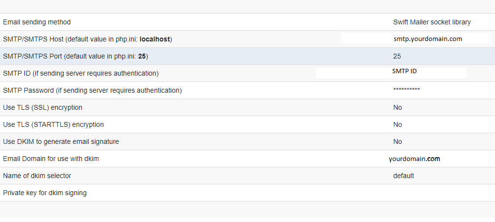

Hi @hORb,
My outgoing settings are
When I click the test server connectivity button, then I got the following response.
Server is available at address smtp.domain.com on port 587

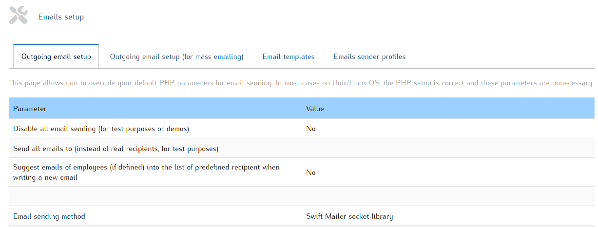

Normally if you do exactly what is described there : https://wiki.dolibarr.org/index.php?title=Setup_EMails#Gmail_.28with_login.2Fpass.29
it should work !
Hello @canfest,
I tried this setting and it’s working again properly.
you can try this setting, maybe your problem will also be solved.

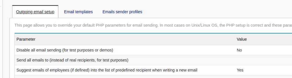

Hello @simicar,
The value of 1st parameter is NO as you can see in the attached pic.
Kind Regards,
Adnan
