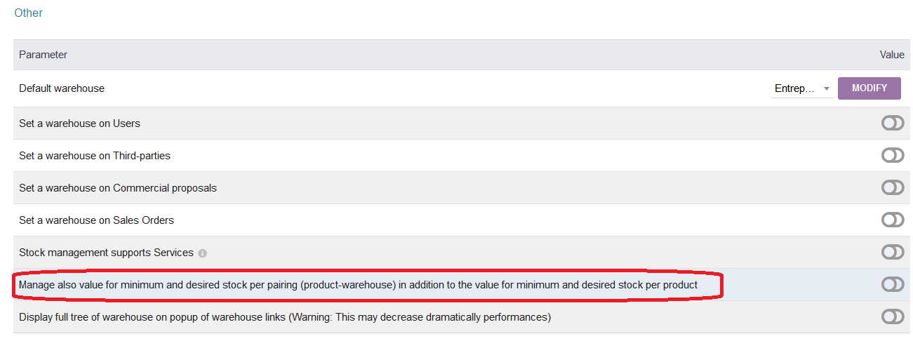

Hey :slight_smile:
you can find this configuration screen in stock module setup…

Hello pcbleu,
Thank you so much for responding.
I have actually activated this and didn’t see the effect that was why i dropped the request for help here.
perhaps i am yet to set something to make that effect happen
Does the setting work for you sir?
Hi pcbleu,
I have seen where to set the stock alert per warehouse.
I did it, did a test, but the stock alert dashboard didnt show the product that has gone below the required level for alert.
Could this be a bug?
any suggestion is appreciated.
Thank you
on the replenishment page, alerts for an individual warehouse will be shown, when you filter for this specific warehouse.
Thanks priojk, i appreciate your feedback. however, nothing showed.
I had done a transaction with sale that went below the stock alert quantity set for the various warehouses and the products didnt show on the product alert widget on the dashboard.
I want to suspect this is a bug, or is anyone’s product alert widget on the dashboard showing products that needs to be reordered or refilled without issues?
Please assist
Thank you

I’m using Dollibar 18.0.1, but I need to activate the limit of stock alert, for each warehouse. I noticed that inside the inventory module, there is an option to enable this feature, however even after it is activated, I am unable to check the alerts.
