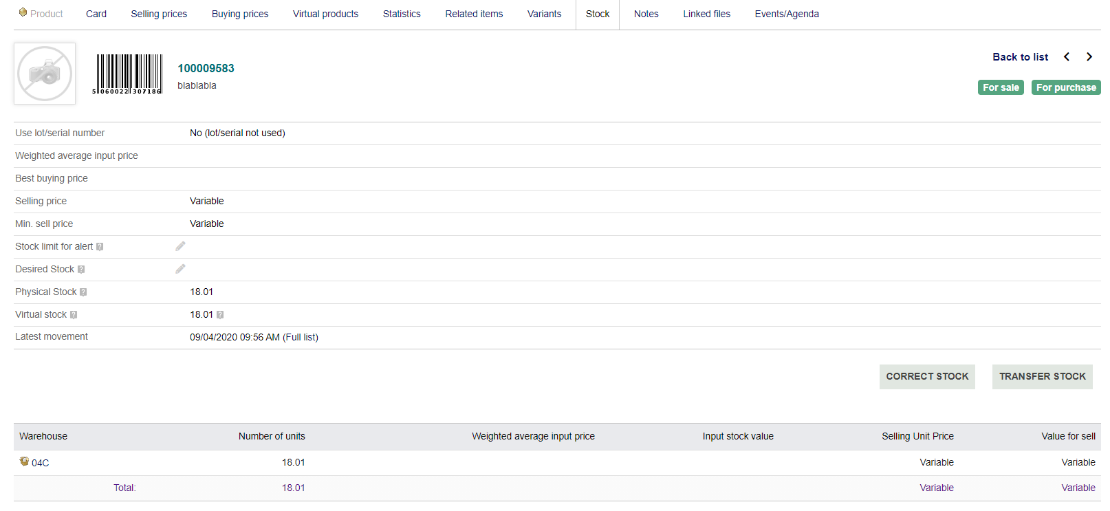

For example, just added 0.01 to stock:
Thanks very much fappels, for your answer! Great to know it worked for you. This helped me in fact to inquire the inconsistency further.
