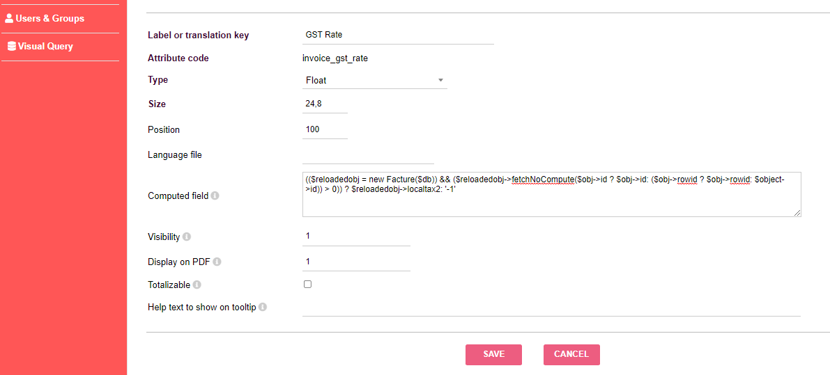

I am facing a strange issue of only particular fields doesnot appear if we use computational field in complementary attributes(lines) of Invoices:
Please refer to below picture:
The same formula WORKS FINE with other parameters. Like few examples given below:
(($reloadedobj = new Facture($db)) && ($reloadedobj->fetchNoCompute($obj->id:(($obj->rowid ? $obj->rowid: $object->id)) > 0)) ? $reloadedobj → ref: ‘-1’
(($reloadedobj = new Facture($db)) && ($reloadedobj->fetchNoCompute($obj->id:(($obj->rowid ? $obj->rowid: $object->id)) > 0)) ? $reloadedobj → total_ht: ‘-1’
(($reloadedobj = new Facture($db)) && ($reloadedobj->fetchNoCompute($obj->id:(($obj->rowid ? $obj->rowid: $object->id)) > 0)) ? $reloadedobj → total_ttc: ‘-1’
Surprisingly, nothing appear if we use localtax1 and/or localtax2 on the PDF when called thru custom field. I have already enabled local tax in setup as well. Thats is:
(($reloadedobj = new Facture($db)) && ($reloadedobj->fetchNoCompute($obj->id:(($obj->rowid ? $obj->rowid: $object->id)) > 0)) ? $reloadedobj → localtax1: ‘-1’
or
(($reloadedobj = new Facture($db)) && ($reloadedobj->fetchNoCompute($obj->id:(($obj->rowid ? $obj->rowid: $object->id)) > 0)) ? $reloadedobj → localtax2: ‘-1’
GIVES ONLY BLANK OUTPUT
Can anyone help how to display localtax1 and localtax2 on PDF generated through ODT

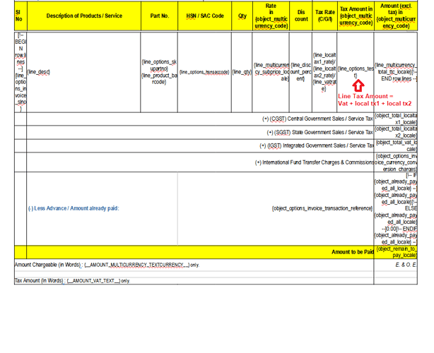

Dear @ksar , @eldy ,
Greetings and appreciate your reply in spite of busy schedule.
Here is what I am trying to do:
Also here is the link for object dump:
https://drive.google.com/file/d/1zj9cGEwG3o0BqYO-WYpxetlThz2nWLln/view?usp=sharing
Just need help to access these fields under:
[“lines”]=> array(3) {[0]=> object(FactureLigne)#214 (143) {
[“element”]=> string(10) “facturedet”
Fields are:
[tva_tx]=> string(6) 18.000
[localtax1_tx]=> string(5) 0.000
[localtax2_tx]=> string(5) 0.000
so that the formula will become [tva_tx] + [localtax1_tx] + [localtax2_tx] = total line tax
thanks a ton,
yesbee.

So my understanding is that
You can show the vat amount, the local tax1 and local tax2 into your ODT. The tag replacement is ok.
But you miss a tag that contains the sum of all of this 3 taxes, this is the reason why you created a computed field ? Right ?
Yes. You are right… bulls eye…
thanks and regards,
yesbee

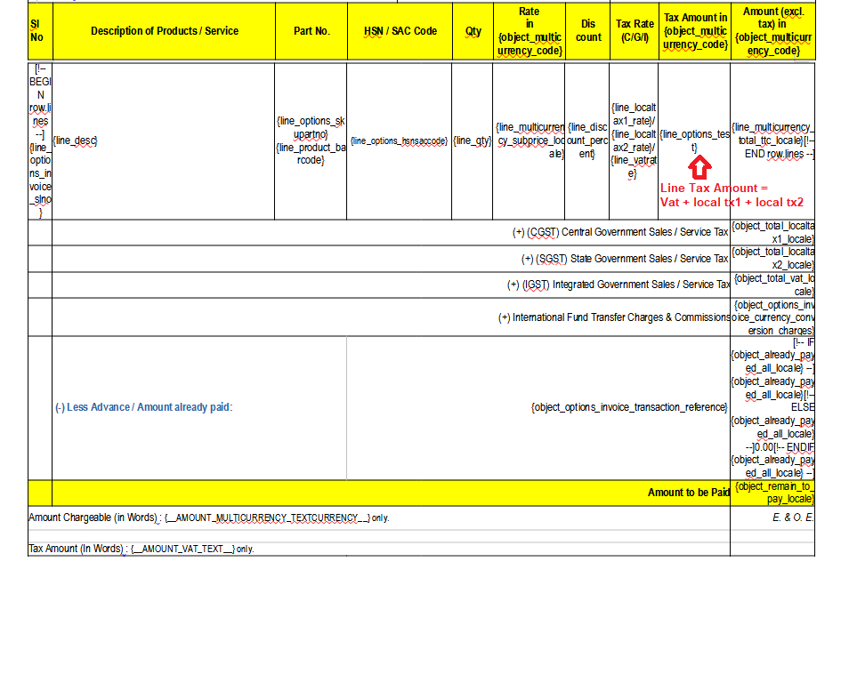

@eldy , @ksar ,
Can you kindly help on how to address “element” in the computation field:
object(Facture)#210 (140) {
$object->lines[0]->element works but I am not sure about how to substitute variable for ‘0’ so that the line number changes for each line.
thanks and regards,
yesbee
Found the solution & it is:
"just add an additional parameter in /htdocs/core/class/commondocgenerator.class.php
with the formula to calculate the tax "
and Voila, it works like a charm…
thanks,
yesbee.
