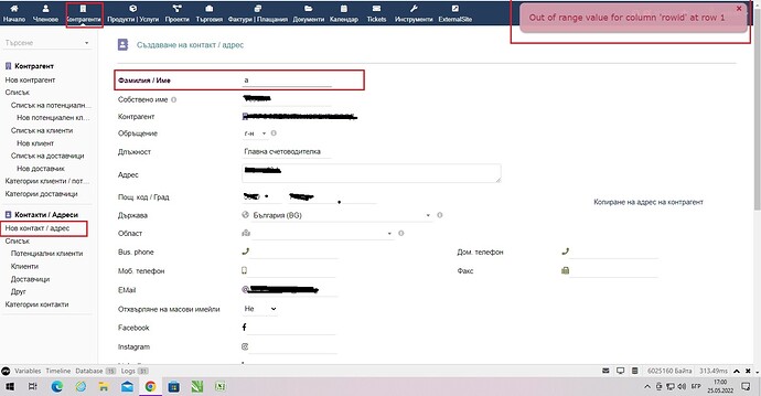

Im just trying to add a new contact. Im attaching an image everything is filled but i keep getting the same error.

Everything looks normal to me here are some screenshots from the database
Can you copy the full sql string that fails (the screenshot shows only the begin of sql)
We’ve sorted out this already. Because of a couple of imports/deletes the autoincrement value for rowid had gotten very big and over the limit.
