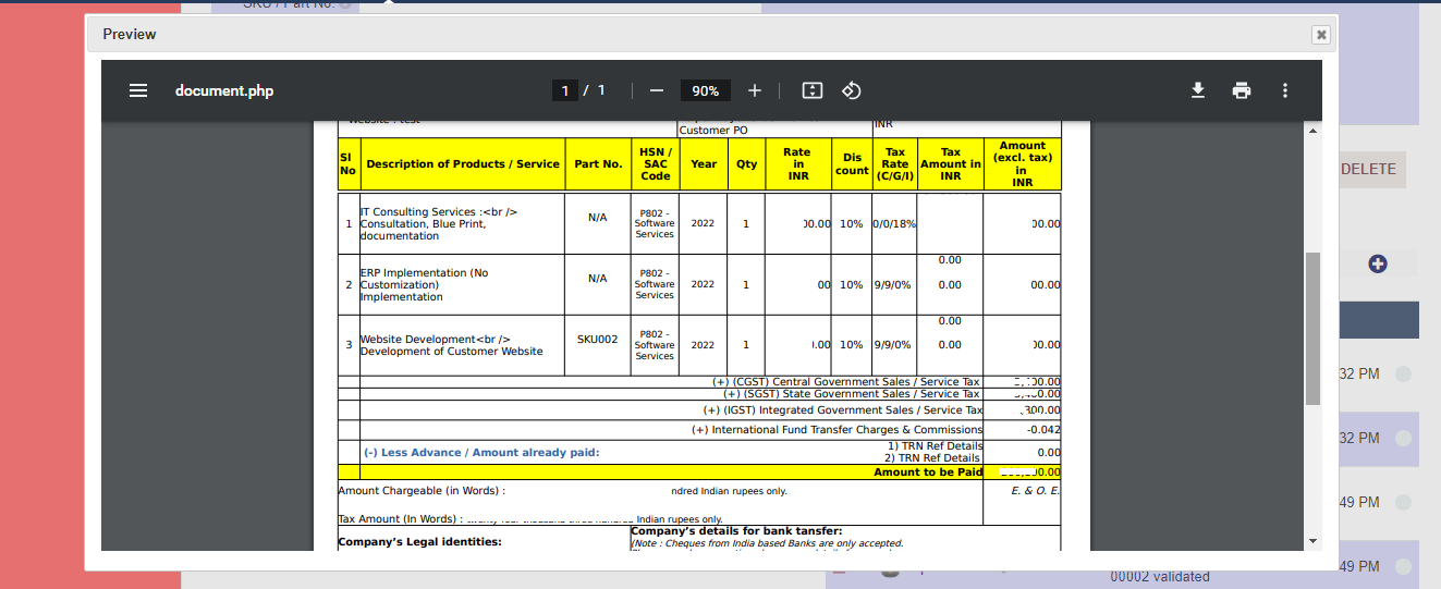

Below is the result:
Basically, it works fine. Just try typing it straight on to your ODT no extra fields needed.

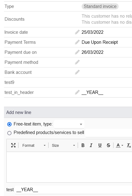

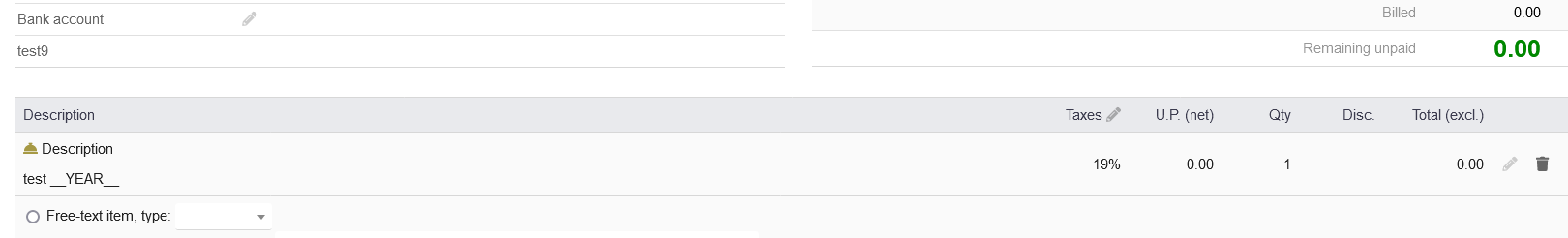

Here are the steps I do:

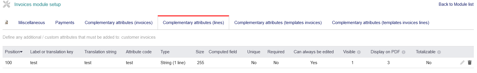

create extra field (line):

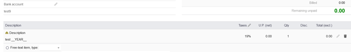

then add product line into invoice:

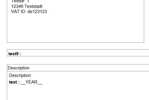

create PDF invoice with the included template sponge → result:
Screenshot 2022-03-25 at 14-08-41 FA2203-0108 - FA2203-0108.pdf

it is not in the description, it is an extra field (line) UNDER the description. It just looks as if it is in the description on my screenshot

Doing the same on the invoice header works as expected (also with the substitution variable __YEAR__ behind it). This screenshot shows the web interface:

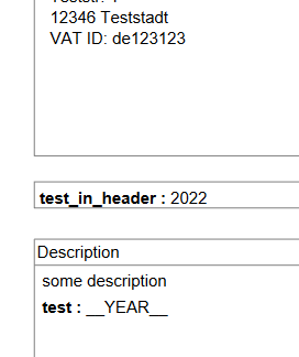

this one the result on the PDF (template sponge):
Screenshot 2022-03-25 at 20-48-46 FA2203-0109 - FA2203-0109.pdf

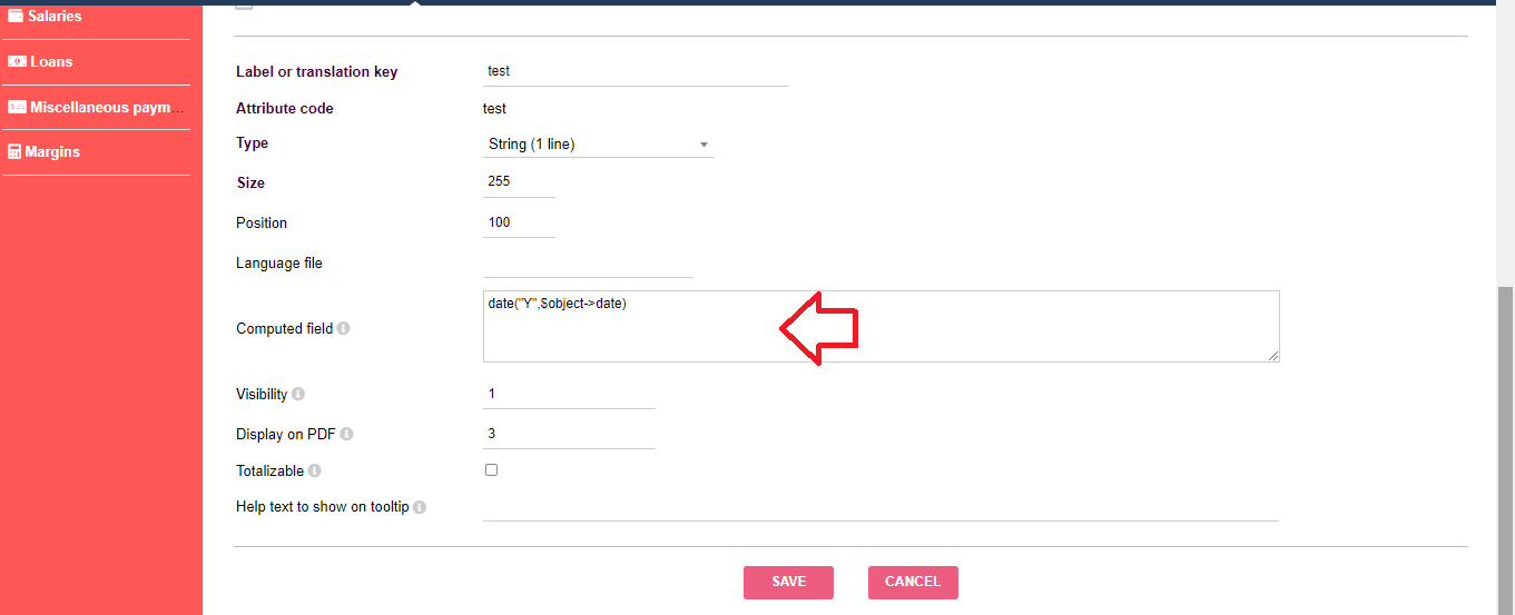

Hello @unrat
I’m late to the party, but do you still have the issue?
As I needed this myself, I investigated and came to realize that variables in invoice line items are only substituted when using the ODT templates, not the PDF template.
And the correct syntax is {object_date} for the date of the invoice.
