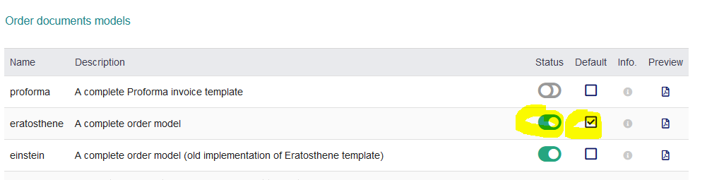

You need to use “eratosthene” PDF Model

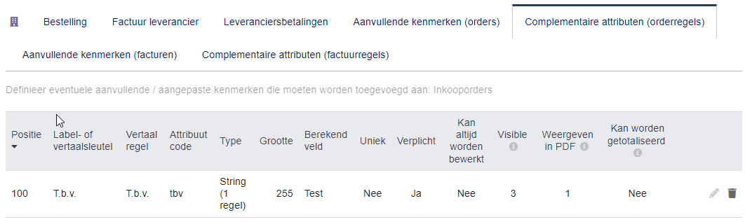

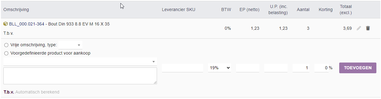

Let me rephrase my problem. I have created a complementary attribute for the supplier module (Setup → Supplier Module → Complementary Attributes (Order Lines)) as follows below.

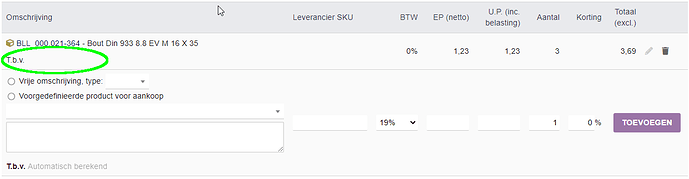

Furthermore, I have created a purchase order containing one product. Here, the extra field ‘T.b.v.’ appears as expected, though without the computed value ‘Test’:
I hope this is clear. I look forward to any suggestions to solve this.

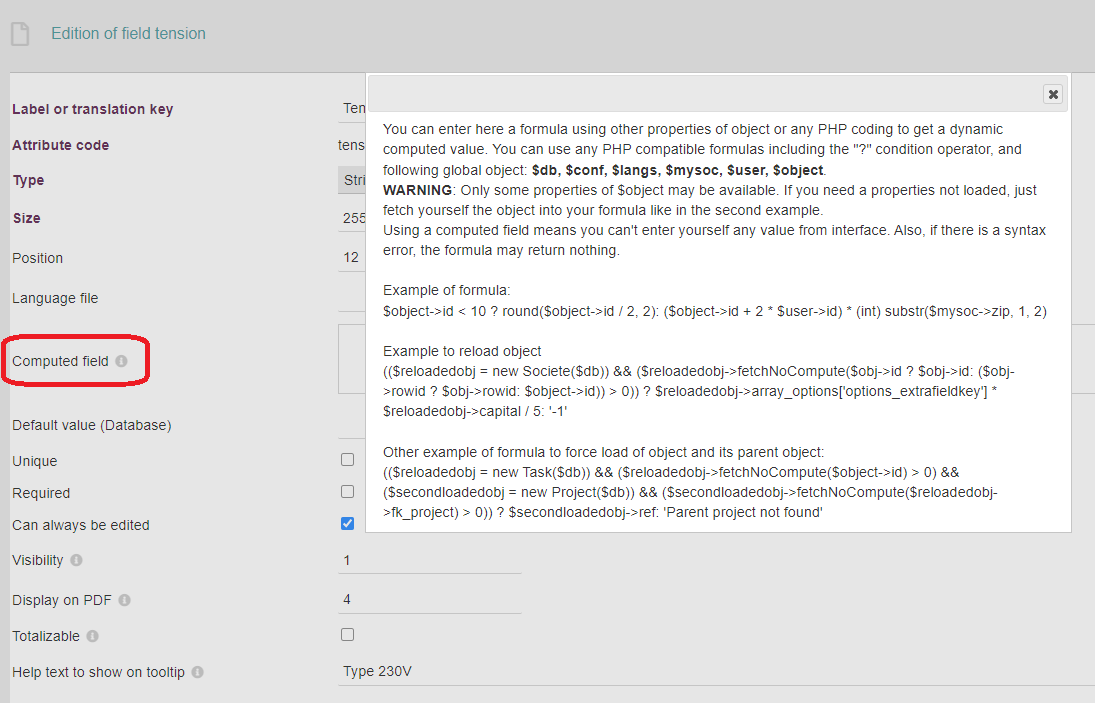

you could find easily the answer, just with this help screenshot
your computed field is probably not valid, you must enter a valid php formula…
try “Test” or ‘Test’ for example

You need to enter a correct PHP syntax
Test, 123, “hi" etc are NOT correct PHP Syntax.

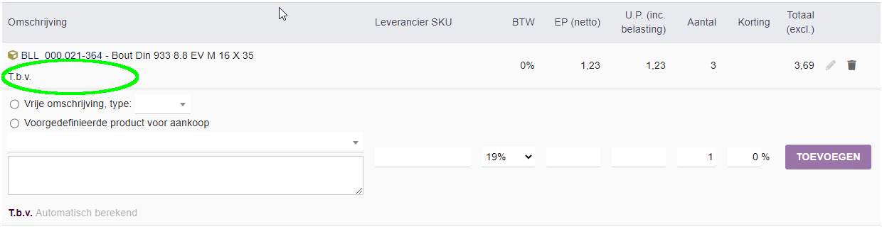

Dear pcbleu,
Creating a new product, as well as a new purchase order does not help. The problem is not about extra fields for the product itself, however, the value of an extra field (in my case called ‘T.b.v.’) for a purchase order line is not presented (see my message from yesterday, 2:06 PM).

Hello :slight_smile:
you just have to indicate a coherent php formula :
→ ‘test’ will work
→ “test” wont work
