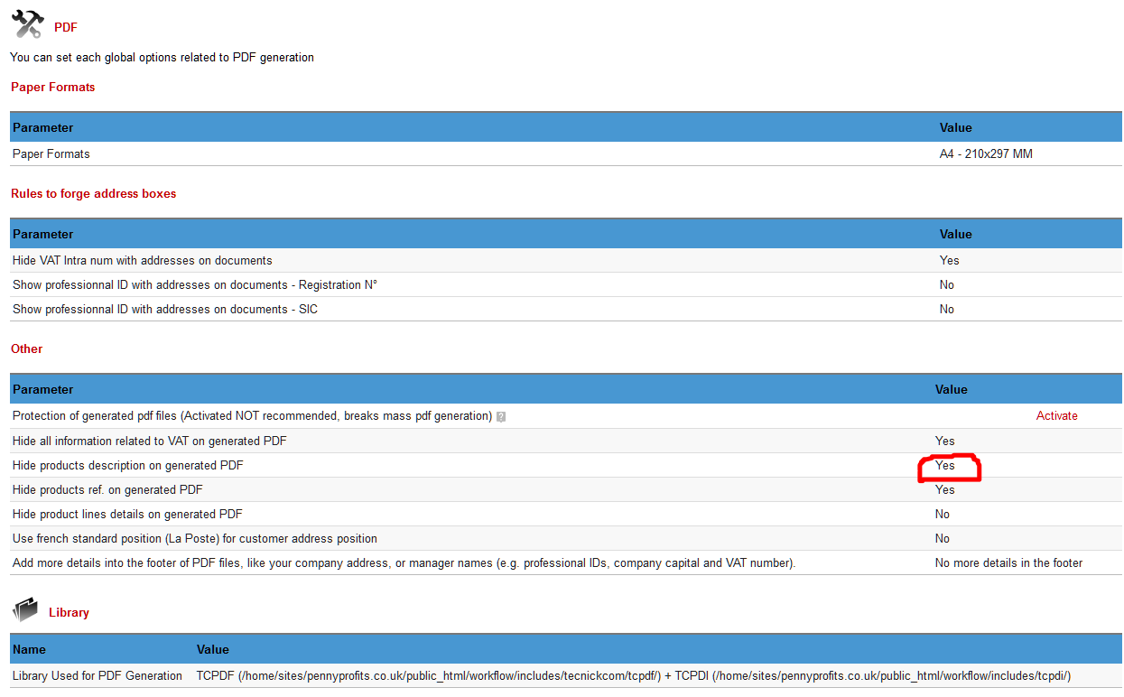

You just need to hide the description…
Go to: Setup > PDF
Hi
Thanks, but that will hide on all documents I suppose? I just want to hide the descriptions on certain documents. For the moment I just want to hide it on purchase order (muscadet) but later also on client invoices.
