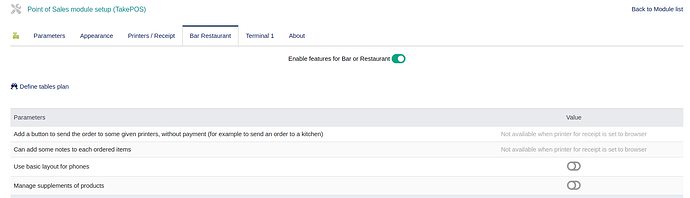

Can somebody explain to me how to set up the Supplements in the takepos in Dolibarr 15.2.
This is for a restaurant setup, where the waiter needs to select the customer’s choice when ordering a meal, Like brown or white bread.
When you are on the setup of module TakePos, go on tab “Bar/Restaurant”. Enable the feature Bar/Restaurant. You should see an option “Manage supplements” to set to on.
Thank you. I see it allows you to select tags/categories. Will setup. it’s looking to me, you have then created the tags. Will try it.
