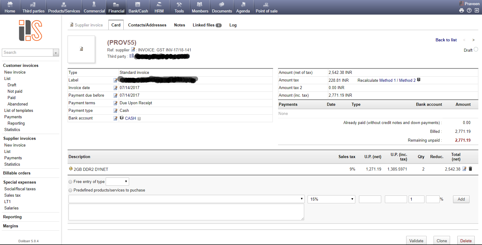

Hi rajiv,
based on your steps i have updated the TAX2 details but while making supplier invoice entire the TAX2 calculation is not working. could you please me help me on this issue.
please refer the snapshot and let me know you command on this.
Regards
Praveen
