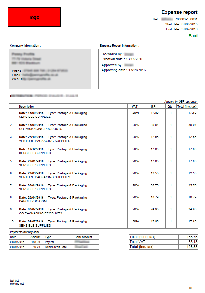

What the PDF looks like
Here’s the general look…

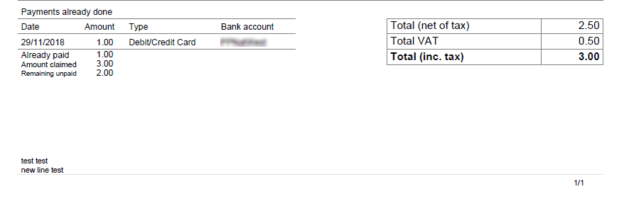

Here’s with the payment table…
Here’s the unpaid section…

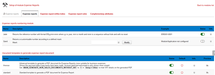

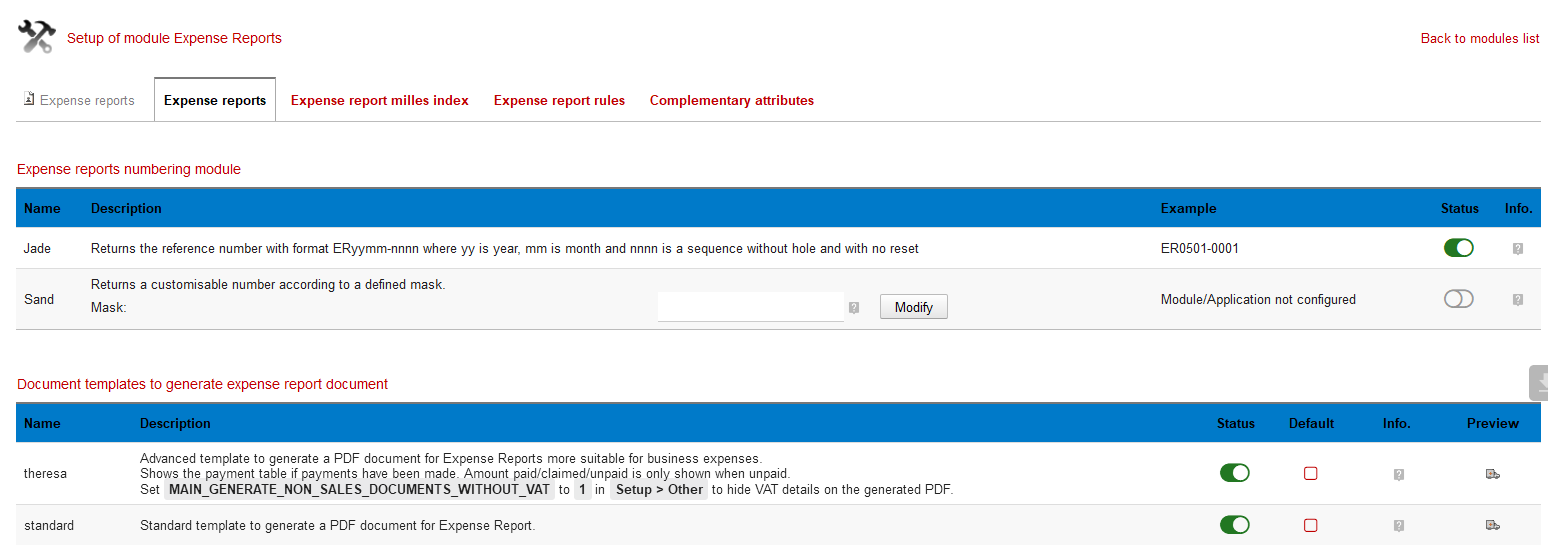

Activate the document model
Finally in Dolibarr, go to: Home ► Setup ► Modules ► Expense Reports

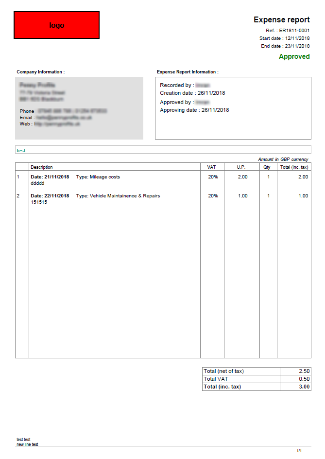

Hello, Thanks for your model. Unfortunately this isn’t working on my system. I have Dolibarr 8.0.1 but the report has the same problem.
Maybe there is another problem?

Hello, I have just experienced (even in this new model) the problem similar to yours. I think it is to do with how many lines in the expense report.
Anyway, my new problem was 36 lines of expenses created 8 pages but only 3 or 4 of the pages had REAL lines on them. In the blank pages it was one value per page - not even a full row.

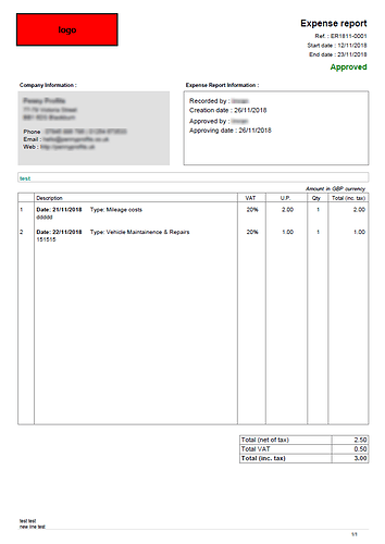

So I have just been playing around to try to get this ‘improved’ and I think I MAY have found the solution.
Try this code and see if it works. It has worked for me and reduced my 8 silly pages to a correct 3 pages.
Replace: (line 307)
$tab_top_newpage = (empty($conf->global->MAIN_PDF_DONOTREPEAT_HEAD)?65:10);
With:
$tab_top_newpage = (empty($conf->global->MAIN_PDF_DONOTREPEAT_HEAD)?50:10);
