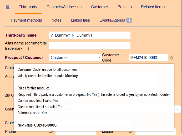

It is possible to change the customer number easily via the web front end. Changed entries are validated according to system specifications, see screenshot.
Am I right in assuming that the parameter $allowmodcodeclient = 0 applies to all update calls apart from the direct change in the Third-party web frontend?
Is there a technical or organizational reason why a modification to the “client code” cannot be initiated via API call? I assume that validation is also carried out here, as in the web frontend.
