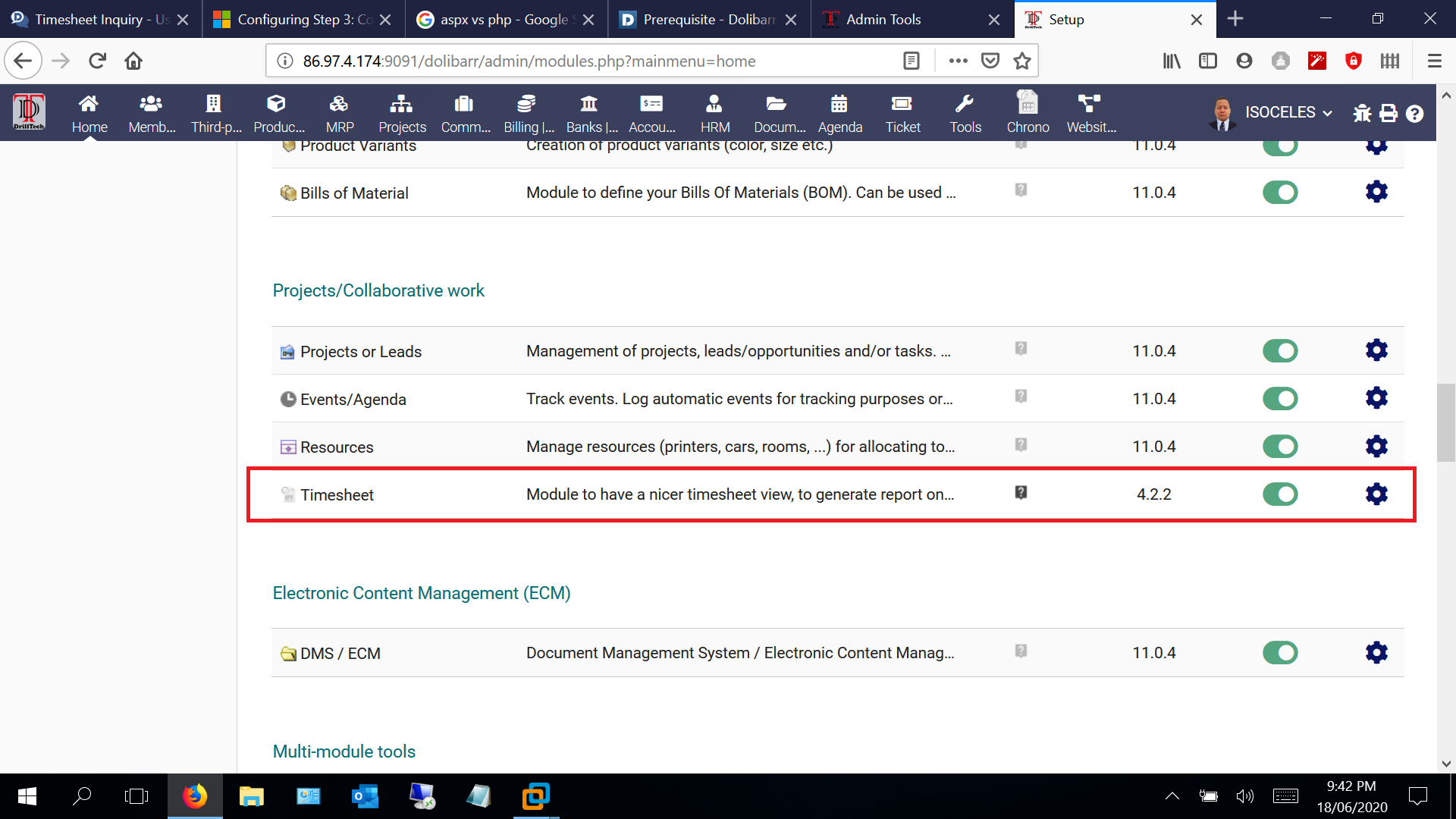

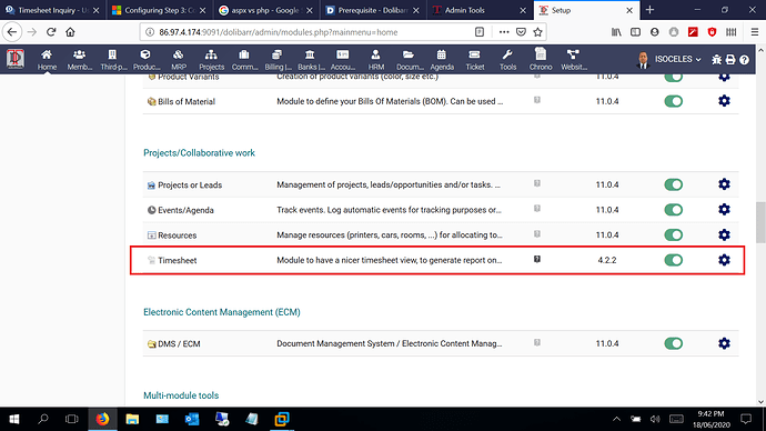

Download it and Put it into Core Directory, Log in as admin then activate it. Please refer to the picture below:

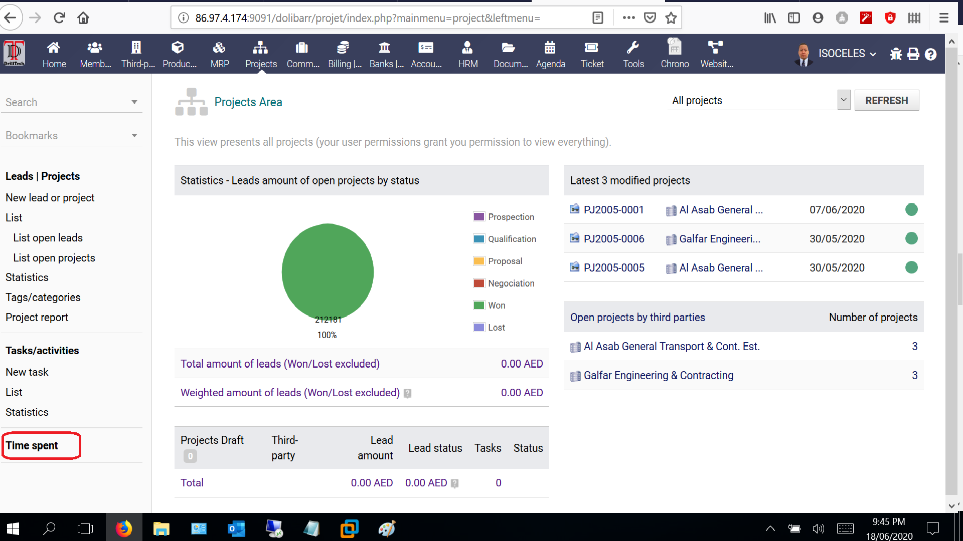

Then activate it per user
Can be accessed to Projects and in HR
Thank you very much! Will do and will update…
Really appreciate your response.
Thanks!! I can see it now.!
Dear,
The timespent you show is from the core, you don’t need to install the module; the module has another entry screen main menu> chrono (or timesheet depending of the modul conf) > timesheet.
the module will add reports, invoicing, approvals …
