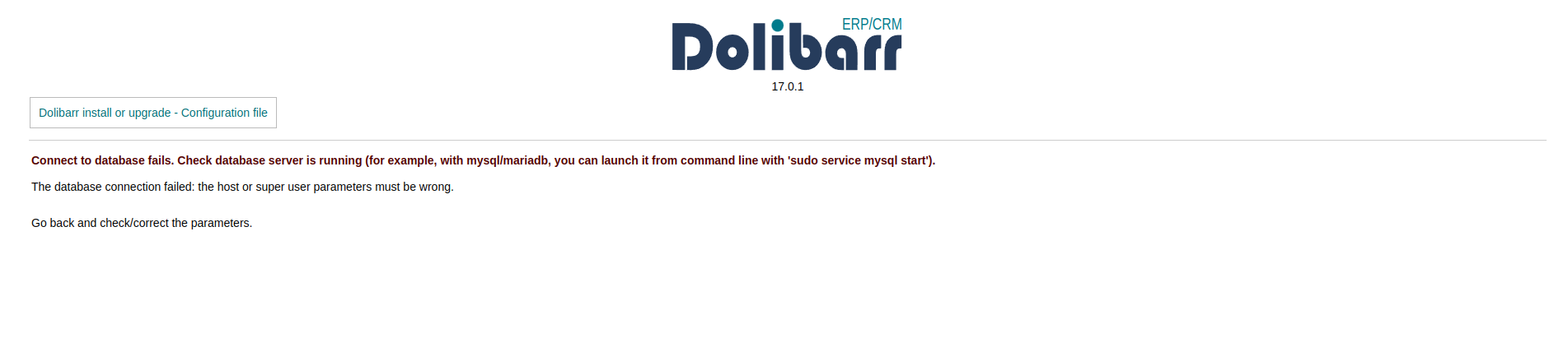

Which then generated this error.
Dolibarr error
I went back and tried adding my root user password at the bottom of setup page but that didn’t work either.
I’m not sure what to do next as a google search and forum search hasn’t really helped although I have found the odd similar scenario but not really a solution.

Have a look here : How to Install MySQL on Linux Mint 20 and Ubuntu 20.04?
Basically, you need to run “sudo mysql_secure_installation” to create mysql admin user.
Thank you. I tried your suggestion but apparently I don’t have MySQL and when I tried to install manually it failed due to unmet dependencies.
workhorse@workhorse-destop:~$ sudo apt install mysql-server
Reading package lists… Done
Building dependency tree
Reading state information… Done
Some packages could not be installed. This may mean that you have
requested an impossible situation or if you are using the unstable
distribution that some required packages have not yet been created
or been moved out of Incoming.
The following information may help to resolve the situation:
The following packages have unmet dependencies.
mysql-server : Depends: mysql-server-8.0 but it is not going to be installed
E: Unable to correct problems, you have held broken packages.
workhorse@workhorse-destop:~$ mysql --version
mysql Ver 15.1 Distrib 10.3.38-MariaDB, for debian-linux-gnu (x86_64) using readline 5.2
workhorse@workhorse-destop:~$ sudo systemctl status mysql
Unit mysql.service could not be found.
I’m fairly new to Linux and most software I have installed has been from the repository so haven’t got much of a clue at the moment when things do not work. Not sure where to go from here as I have uninstalled and reinstalled but nothing has changed.
No clue, you should ask why mysql-server doesn’t want to be installed on Linux Mint forum.
