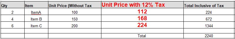

I would like to request for a help for how to include unit price (INCLUSIVE of VAT) in ODT template. We are using {line_up}. Any help would be really appreciated. We tried to creating substitution as well, but the value of globa variables are not accessible inside PHP functions.

The one tag which is similar to this is {object_total_ttc} but that provides us the total of invoice. What we need is unit price per item inclusive of 12% vat.

Thanks but, it still does not solve the issue. The output is 178.57+12% instead of 199.99
The closest possible output could be {line_price_ttc_locale} / {line_qty} as it also includes the reduction, but in output odt it shows the value as it is without any calcluations :unhappy:
