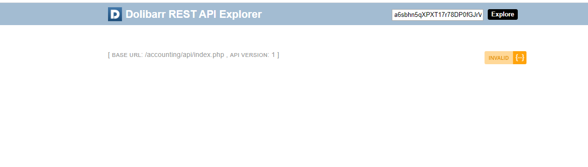

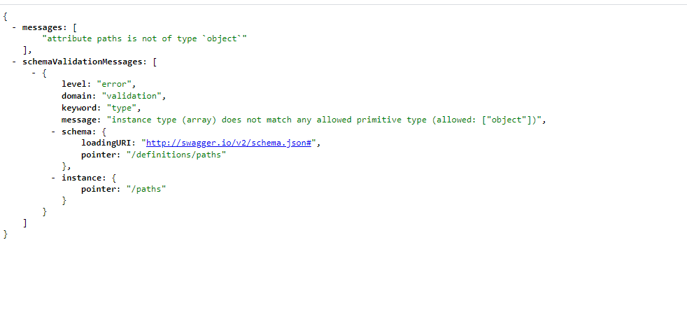

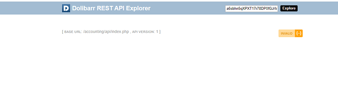

No i didn’t manage to get it woking in the API explorer.
So i have just upgraded to 11.0.1 and now its worse. I cant even get the categories to load
Hi shaggy, it looks like your api key was not recognised (The orange Invalid message). Maybe you could regenerate one and retry. Once you get “logged in” you will access the various apis.
