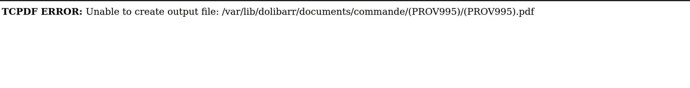

i have try to install it again with a new download but it still gives error see attach picture
and this is install on a local machine

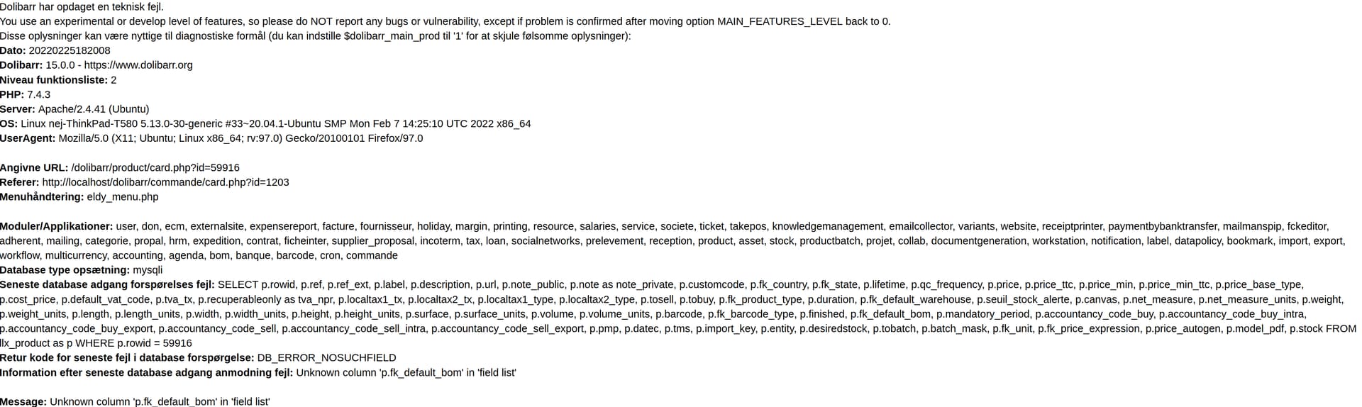

i still have this problem with my try out server see picture

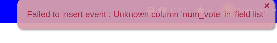

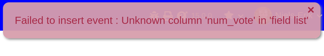

Failed to insert event : Unknown column ‘num_vote’ in ‘field list’
is there any that have seen this before i can see some french have same issue back in update from V13 to V14
i have now upgrade to V15.0.1 and i get this in my log see under here but still same error as before
Any help to this issue it look like missing field in database but it must be relatet to v14.0.4 or 5 See log in attach pdf DolibarrLog.pdf (70.5 KB)

I found that it miss this 3 table/parameter in Data tabel llx_actioncomm ? see picture but is it the right set of data or shut it be integer or something
Answer is there : dolibarr/llx_actioncomm.sql at develop · Dolibarr/dolibarr · GitHub
num_vote integer DEFAULT NULL, -- use for Event Organization module
event_paid smallint NOT NULL DEFAULT 0, -- use for Event Organization module
status smallint NOT NULL DEFAULT 0, -- use for Event Organization module for now, but could be use after for event global status
yes then it is working on my try out station.
